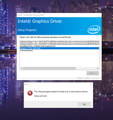

You said you had the latest graphics driver installed but what you have is actually ancient. You have build 6952 installed but the latest from Intel is 8336 (there's also a Beta 8425 if you want to try that).
8336 is available here: https://downloadcenter.intel.com/download/29674/Intel-Graphics-Windows-10-DCH-Drivers
Beta 8425 is available here: https://downloadcenter.intel.com/download/29679/Intel-Graphics-BETA-Windows-10-DCH-Drivers
Well, that's not good.
The standard response for cases like this is to do a from-scratch installation of the new driver...
Manually uninstall the existing driver package, reboot and then install the new package. I usually start in Apps and Features and uninstall the Intel Graphics Driver entry. If no entry exists, start up Device Manager, expand the Display Adapters section, right click on the Intel HD Graphics entry and select Uninstall Device. When the Uninstall Device dialog appears, place a checkmark beside the Delete the driver software for this device question and then click on Uninstall.
