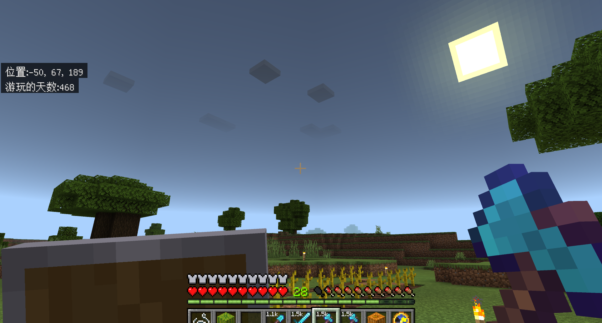

显卡驱动更新到32.0.101.6881后,首先显卡软件显示不支持我的设备(图1),然后在玩我的世界的时候白天的天空看着很黑(图2,图3),越是接近太阳的地方越黑,正视太阳的时候也更黑,上个版本的时候还没出现这个问题。

Thank you for posting in our Community and for providing detailed observations about the issue you're encountering after updating to driver version 32.0.101.6881. Based on your description, there appear to be two key concerns:
  1. The Intel Graphics Software or related utility reports your device as “not supported.”
  2. Minecraft displays abnormal lighting and color rendering, particularly when looking toward the sun.
These symptoms may point to a regression or compatibility issue introduced in the latest driver build. To assist you further and escalate this appropriately if needed, could you please help us with the following information:
  • What is the exact model of your device (laptop/desktop)?
  • Was the driver installed via Windows Update, Intel’s website, or the system manufacturer?
  • Does the Intel Graphics Command Center open at all, or does it crash/produce an error?
  • Do other games or applications show any graphical abnormalities, or is the issue isolated to Minecraft?
Additionally, it would be extremely helpful if you could attach a System Support Utility (SSU) report. This will allow us to review your system configuration and driver stack in more detail.

1.我使用的设备是笔记本电脑,型号是HUAWEI Matebook D 14(NbF),系统版本为Windows11家庭版24H2。我使用的外接显示器(品牌为AMZFAST,型号为25X1,HDMI接口支持180Hz刷新率的数据输入),通过HDMI接口将笔记本电脑和外置显示器连接,电脑画面仅在外接显示器上显示。
2.驱动程序是通过Intel Driver & Support Assistant下载并安装的,但期间经历过一次安装失败,第二次安装成功了。
3.驱动程序在游玩我的世界的时候已经打开,并且没有出现崩溃的情况。
4.其他游戏及图形程序异常暂时没有发现。
此外,上报此问题当天我就把驱动程序更改为gfx_win_101.6790版本,解决了上述部分问题,比如我的世界基岩版游戏中着色器异常,以及我的驱动无法识别我的硬件。
但是当今天我再使用电脑的时候,Intel Driver & Support Assistant无法检测我的电脑的硬件信息,重新安装该软件也无济于事,尽管我重新安装所有intel驱动程序也没能解决这个问题。
不过当我今天再次通过Intel官网下载显卡驱动程序gfx_win_101.6881并安装后,我的世界游戏问题以及该显卡驱动无法识别硬件问题也解决了,但我的外接显示器支持180Hz,显卡驱动软件只能以最高120Hz的刷新率使用我的显示器。
