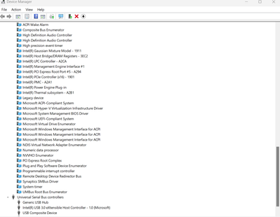

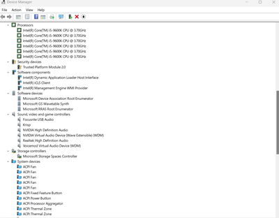

I have been working on the investigation, and now I have a question:
- Check the device manager, check for any yellow bangs/errors, and take screenshots of it. If there is an error message this will help me to try to find the reason of the issue.

Hello GhostInASock,
Thank you for your reply, the information provided has been really helpful.
Let's try to perform a clean installation of the graphics driver with Display Driver Uninstaller (DDU) to version 31.0.101.4826 to check if the behavior changes. For guidance, How to Use the Display Driver Uninstaller (DDU) to Uninstall an Intel® Graphics Driver.

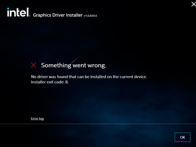

I started my pc on safe mode cleared the GPU drivers with the DDU restart, opened drivers installer you sent me but i got this error
i attached the error log

Hello GhostInASock,
Thank you for your response and for letting me know the results.
The reason why you received the error message is that the Intel® Arc™ A770 Graphics was not installed in the system in order to install its driver.

Hello again,
The arc a770 still did not boot again and i had to boot the PC without it to try and install the drivers. But i still get the error 8 "No driver has been found that can be installed on this device". I attached the error log again if anything changed.

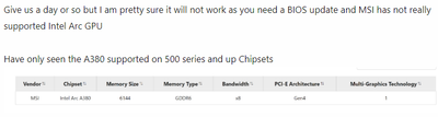

In the meantime, i contacted MSI to ask more information about the motherboard here is what they told me:
They said that my motherboard is not supportive of the GPU. I frankly don't understand how that would make it not even boot since from what i read in intel's website about the GPU before buying it, it only mentioned possible stability or performance issues but now outright failure to boot.

Hello GhostInASock,
Thank you for your time.
I have been working on the investigation, we confirmed this is a motherboard compatibility issue, since the graphics card was tested and confirmed to work properly on a different system. I suggest you use a different motherboard or work with the motherboard manufacturer to get a BIOS update to improve compatibility with this graphics card.
