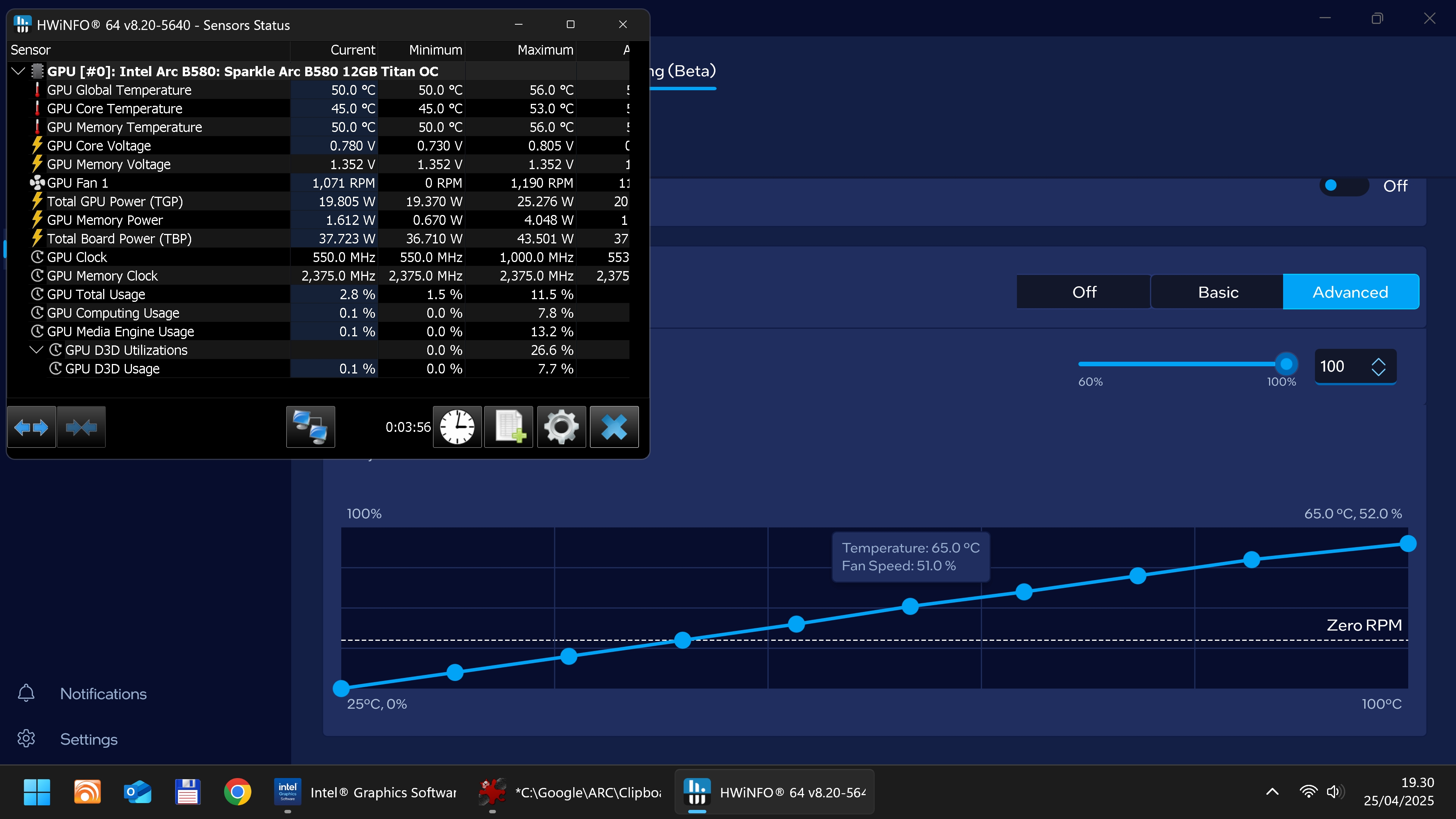

If you customize the fan curve, the 0% line is ignored, and the fan runs all the time.
Even if you switch back to "off" stock setting, the fan still runs even though the card is below 30 degrees C. Only a reboot can bring it back to normal. But if you modify the curve, just move one of the balls slightly, and save settings, then the fan will be on no matter what temp the gpu is.

First picture, I have just pressed "advanced", and then "appl changes"
And everything is normal. Fan RPM is zero because it is at 56 degrees
Second picture, I have just pulled the 65 % bubble 1 degree higher from 50 to 51 degrees, and then pressed "apply setting"
Now the RPM shoots up to over 1000rpm
Third picture I just fragged all the bubbles down to zero just too see what happened. It reduced the rpm, but never off.
Fourth picture I have turned off fan tuning, and saved settings. RPM is fluctuating from 0 to 800+ rpm and will never settle at 0
Fith picture shows the metrics page. I have to reboot for the fan to go into 0 fan mode again
Six, my system info.
