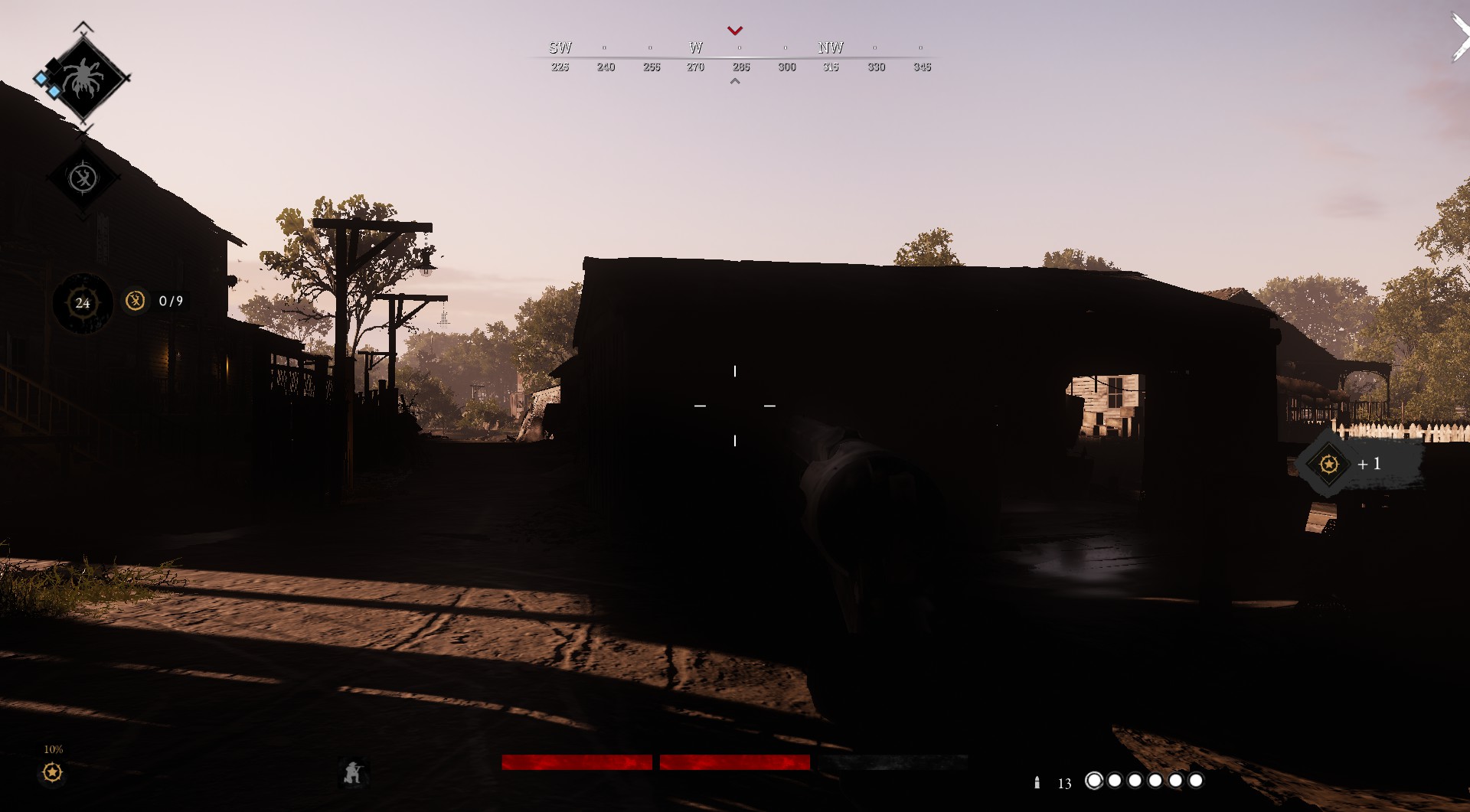

after upgrading to an Intel Arc B580 I've been encountering some issues when trying to play my favourite game!
Graphics Driver Version: 32.0.101.6256
SSU Report: attached in post
Game: Hunt: Showdown 1896 (Steam)
Graphics Settings: 1080p, Fullscreen, Low Preset
Issue(s):
Terrible performance and very inconsistent frame rates that get progressively worse over time.
In all other games (with one exception but i think its because its dx11?) i have tried it's performing as it should.
CapFrameX files are attached to this post, didnt let me upload json files on their own so in a zip.
I would expect to be able to play on higher graphics settings presets with my graphics card but i can't even play the game on the lowest due to the frame rate drops and constant stuttering. My old non-intel gpu that was far less powerful performed better than this.
To me the gpu utilization seems kind of low but i have no idea.
Generally, it's doing better in the soul survivor gamemode. When i started playing the normal gamemode with teammates it got significantly worse. In the end i played soul survivor again but it was also doing worse than the other times i played it.
You can reset this decline in performance by deleting the shader folder in the game files but its only a temporary fix because it gets bad again really fast, especially when playing the normal gamemode.
Another issue i encountered after upgrading to an intel gpu was that sometimes the shadows of the game get overly dark to the point you cant see anything in them. The darkness spreads out from a square that randomly appears on the screen and it can also disappear again for a while. It didnt happen today when i took the performance captures but you can fix it by changing your global illumination setting which is problematic when you combine this with the first issue. It will definitely come back when you switch back global illumination to low. Restarting seems like the only semi-reliable fix. Screenshot how it looks is attached.

Regrettably, my friend and I experience the same issues as the OP.
Me and a friend have exactly this problem. The screenshots resemble exactly what our games look like. I hope for a fix soon since Hunt Showdown is by far my favorite game and it's currently UNPLAYABLE, literally UNPLAYABLE. I can not see any enemies, even if they stand right in front of me!

Hello 986,
Thank you for bringing your concern to our attention and providing detailed information regarding the issues you're encountering with your Intel Arc B580 while playing Hunt: Showdown.
I understand how frustrating inconsistent frame rates, performance, degradation, and graphical glitches like overly dark shadows can be.
With that being said, I noticed that you are currently using the driver 32.0.101.6256. As of the moment, a newer Driver Version is available, which would be 32.0.101.6449.
I highly advise for you to perform a Clean Installation to avoid any errors.
Kindly let me know if the issue persists with the new driver.

the issues still persist after a clean install of the new drivers. Once again the game didnt run great but stable in the beginning and it became very unstable after a bunch of matches. I'm really not sure if it's a coincidence but the sudden decrease of performance happened one match after playing with a teammate again. The shadow bug also still exists.
Thank you,
986
This is the exact same problem on the ARC A770 including weird white fog in the buildings that makes it impossible to see anyone regardless of in game settings. Updated the drivers and clean installed but problem still persists as of 1/18/25. I added pics of the fog as well also as the shadow issues just like OP. I play at 1440p but exact some problems at 1080p too. @RobbieR_Intel

Has performance improved since Jan? I'm thinking about getting a B580 - Hunt is the only game I play
For me, performance has significantly improved compared to January and doesnt degrade anymore over time. I get around 120fps on low/medium settings (B580, Ryzen 5 3600). Still experience frame drops when a lot is going on like a bunch of fire or in some parts of the maps but that might just be the fault of my cpu? Its definitely playable though. Keep in mind that the devs don't officially support Intel Arc cards so if something breaks, then you are out of luck and can only hope it magically fixes itself someday. This is just my experience and it might vary like the various lighting bugs people experience(d?).
