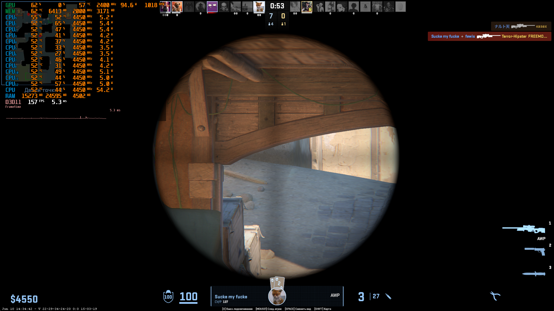

Throughout my use of this video card, I see very low fps in Counter Strike 2 (and TF2 on Suijine card and some others). I would like to try and resolve the issue with someone knowledgeable in this topic, as I am alarmed by these numbers.
My PC:
Amd Ryzen 5 5600
Intel Arc A580 ASRock Challenger
DDR4 Kingston beast 3200mhz 32gb (16x2)
Msi b450m-a pro max II
Settings in cs2 - low.
Settings in TF2 - first three settings are high, the rest are low.
all games are stored on m.2 nvme Apacer AS2280P4 512gb.
In Counter Strike 2 with low settings i have around 120-150fps.
In Casual mode In CS2, where there are more players, fps even worse.
-vulkan doesn't helped me
And also my GPU Usage in this games around 40-50% (I guess it's not good)

My settings in CS2 all is low, but Anisatropic Filtering - 16x.
Here is my CapFrameX screenshots.
I forgot to say that it was on the map for FPS testing, I think it would have been worse in Casual mode in Counter Strike 2
