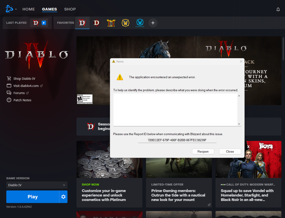

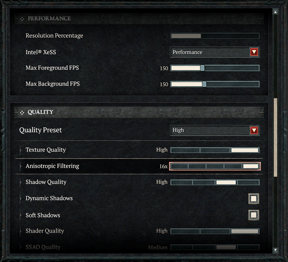

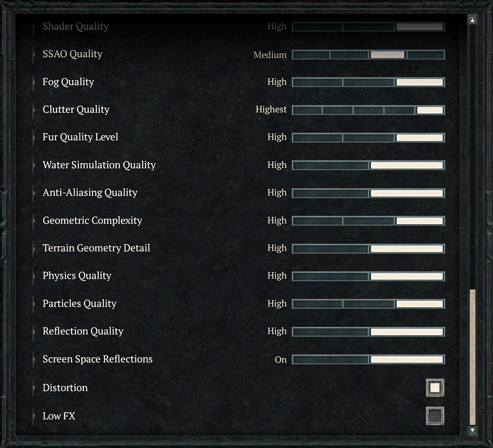

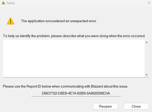

Hello Alberto,
Yes, I do see error messages when the game crashes. Please see the screenshots below. I've also included screenshots of my game/video settings. The game/video settings are default 'High' with Intel XeSS set to Performance.
I've experienced the most crashes when teleporting, whether from dungeon to town, town to dungeon, town to town, random place in world to town, taking my portal in town to return to where I was, etc. However, I've also experienced crashing when talking to vendors. I do not recall crashing while fighting monsters.
I always crash at least once within an hour of gameplay. The screenshot of the error message was from playing this morning for about 20 minutes. I was teleporting to a nightmare dungeon I just opened up from a nightmare sigil when this crash happened.

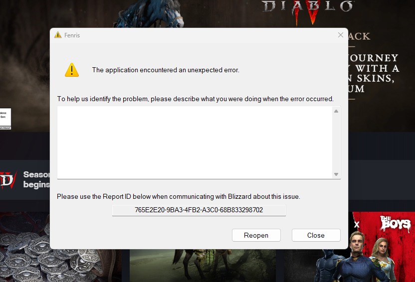

Spicy
9,741 Views
Hi Albert,
I am surprised that your team has not been able to reproduce the issue. Multiple users have replied to my post sharing that they have had the same experiences.
I ran the SFC tool as instructed and observed multiple crashes after playing for a few hours.
This morning I performed a clean install of Windows. Within an hour of playing, my game crashed. Screenshot of the game crash message is below.
Is it possible that my video card is defective?

Jean_Intel
9,107 Views
Hello Everyone,
We appreciate your patience.
Could you provide us with a screenshot of the graphics settings for the game you are currently playing? This information would greatly assist us in reproducing any issues you may be experiencing.
