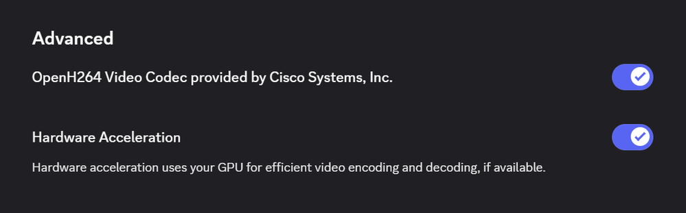

FYI: disabling hardware acceleration in Discords settings doesn't fix this issue.

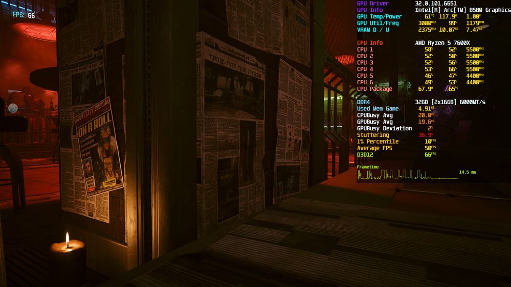

Screen Share OFFScreen Share OFF

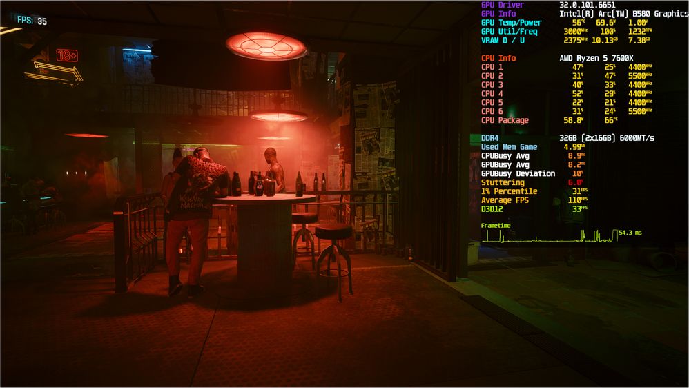

 (Please keep in mind the frame time becomes stable after turning OFF Screen Share, from right to left. The below image shows a flat frame time BEFORE Screen Share is on to which you can see it start becoming erratic, the beginning of the fluctuations-- ergo the poor performance)
Screen Share ON: 117.9w | Screen Share OFF: 69.6w
Screen Share ONScreen Share ON

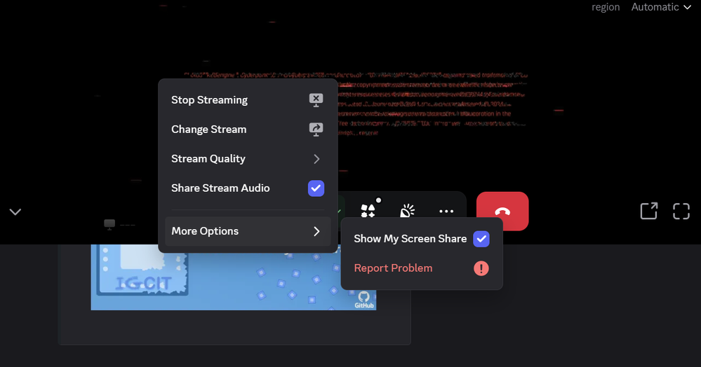

Workaround
The quirky solution was relatively simple, it's unchecking "Show My Screen Share" and it works across all resolutions and framerate options.
Right click your Screen Share to see these optionsRight click your Screen Share to see these options

Things that didn't work: messing with VP8/H264 and HA. Hopefully this is fixed with a driver update.
