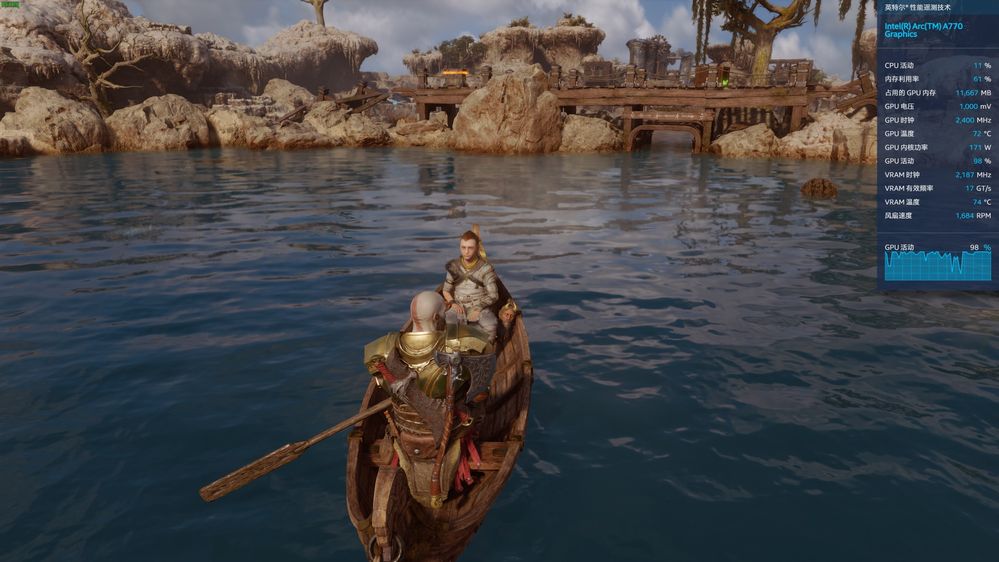

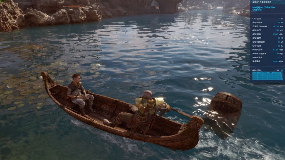

During the game, the GPU usage will randomly drop from 99% to 1% at irregular intervals.
The power consumption of GPU has dropped from 172W to 50W.
Causing the game frame rate to drop from 40 frames per second to 1 frame per second.
Seriously affecting the gaming experience

I have found the cause of the issue.
The reason for the game lagging is due to using an XBOB controller.
When connecting the XBOS controller in Bluetooth mode, it causes frame drops in games. However, this does not happen when using a wired connection.
