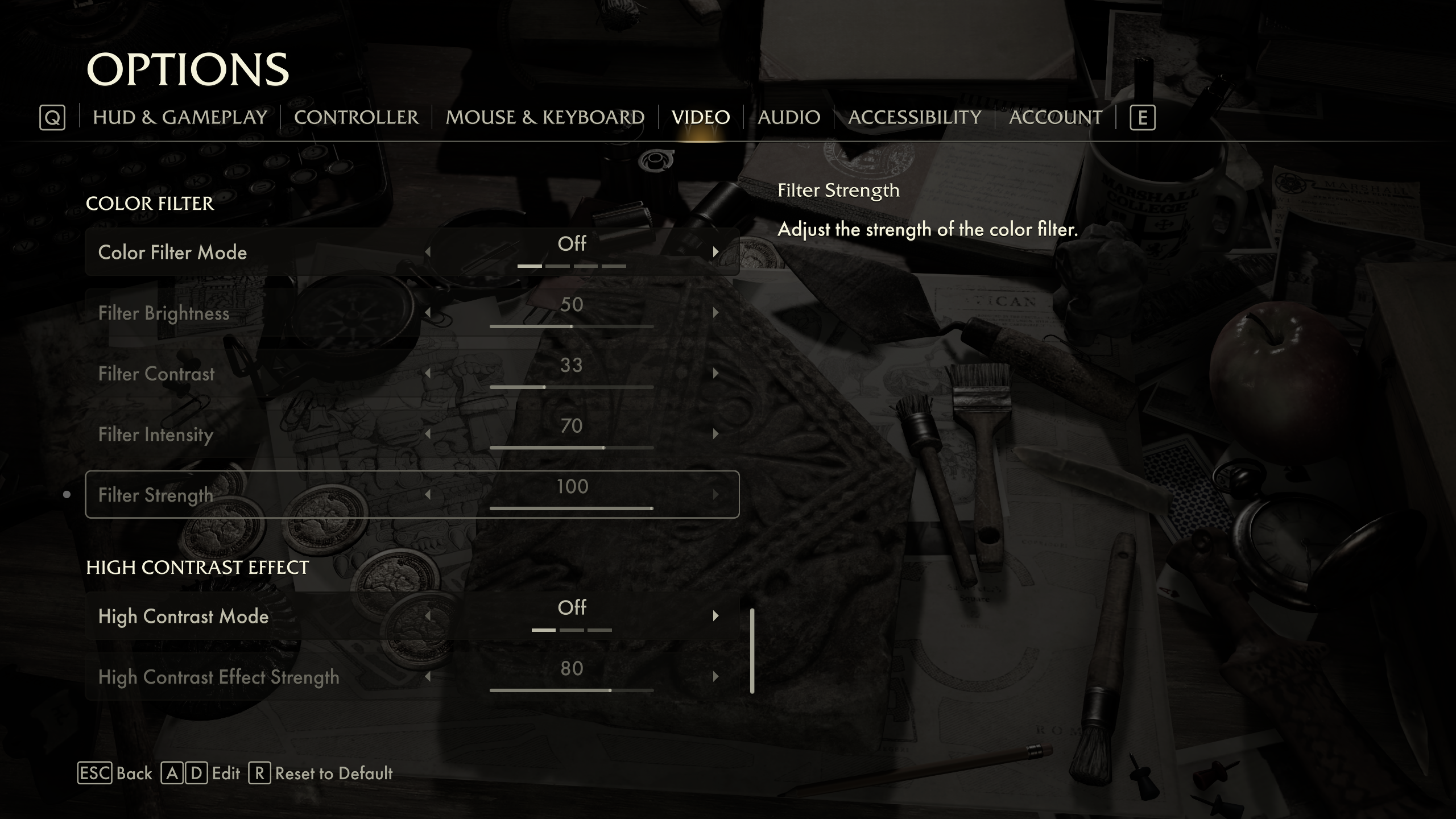

when I try to start Indiana Jones with Path Tracing Option enabled, the game crashes with the "failed to allocate video memory" message I've attached.
I'm running the latest WHQL driver: 32.0.101.6647 and ReBAR is enabled on my Z890 Taichi OCF.
The A770 should have enough video memory, to start with PT enabled, so I guess it's some driver issue.
Best regards!

Thank you for raising this concern within the community. To assist you more effectively, could you please provide a screenshot of the settings? This will help me investigate the issue with Indiana Jones further. Additionally, if you have access to the game, please share the CapFrameX results so I can analyze the FPS.

I'm running WQHD resolution with maxxed out graphics settings. It's running well WITHOUT path tracing (full ray tracing).
... as soon as I activate the 'full ray tracing' option (path tracing), the game crashes with an video allocation error (posted in the first post). I know of at least one other user on the german https://extreme.pcgameshardware.de/ forums, who has encountered this problem through multiple driver versions.
Therefore I obviously can't do any CapFrameX runs with this option enabled.
This is of course with the A770, as the option isn't available for the B580 due to the lower amount of VRAM.
Best regards!

thank you for your patience. Here are the setting screenshots, I've added two comments on the screenshots.
I'm suspecting VRAM management is acting unexpectedly, as there should be enough VRAM on the A770.
Best regards!
