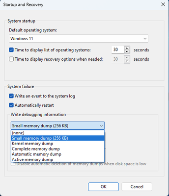

I recently registered on this forum to contribute to the Intel community. This year, I bought an Intel ARC A770 16GB LE graphics card.
The graphics card was causing crashes approximately every 2-3 weeks. I purchased my card in April 2023.
Around September, there were no crashes at all. However, today, with the new Intel ARC driver, I experienced a new crash.
I was doing almost nothing, just started my PC and opened Firefox to watch some YouTube videos. Then, I minimized Firefox and started watching the "Oppenheimer" movie with VLC on my PC.
Suddenly, I had the crash. I uploaded the minidump file and my PC info. I hope that helps.

In this case, based on the minidump file the module that failed is igdkmdnd64 which is related to the graphics driver, however, the crash could also be caused by the app itself so what we could advise is a reinstallation of the latest driver version 31.0.101.4972 using Display Driver Uninstaller, to get rid of any corrupted file or module and also keep your system with the latest updates.

When I install the new Intel ARC driver, I always use the "clean installation" option. (Though I have never used the "Display Driver Uninstaller" program, so I will try it). Unfortunately I had 2 more crashes with the same conditions.
Here is the dump files: 120223-8046-01.dmp, 120423-9765-01.dmp
https://drive.google.com/drive/folders/13mET4XXtdqB-IwmjfxYUfVKZuUDLRITo?usp=sharing
But I will try using the "Display Driver Uninstaller" program. If I experience another crash, I will inform you.
If you suggest, I can change the memory dump file precision (if that helps you more).

Yes, I installed the DDU and also the newest driver. I will report if I have new crashes. Also, thank you for your support!

The system is now run perfectly without any crash. I will inform you if this changes. Maybe the Intel team can integrate an auto diagnostic tool into the Intel ARC control which can send reports to the programmers if a crash occur. Of course If the user enable this feature.

I think the problem is now solved. We can close this thread. Ty for the support!
