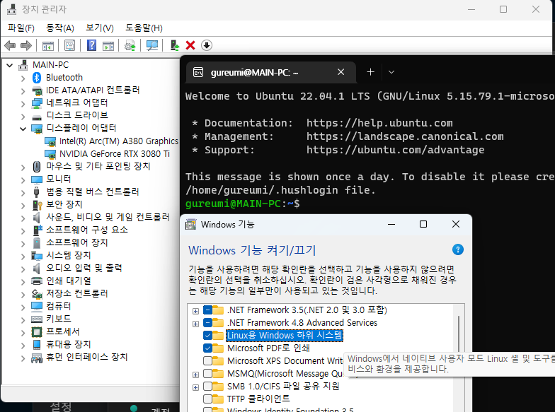

This's a problem I discovered right after installing the Intel ARC A380.
Even after removing the 3080 Ti, the problem persisted.
As a result of estimating the cause by trying several methods, the Intel GPU Driver used STTub30.sys, which is too old, and Hyper-V must be enabled to use WSL2 in Windows OS, but STTub30.sys doesn't support virtualization (7 year old driver), so when Hyper-V is enabled, an exception is thrown and the Intel GPU driver is not loaded.

When I first reported the problem, it was Windows 11 22H2.
Current windows version is Insider Preview 10.0.22623.1020 (ni_release)
Intel driver version is now 31.0.101.3802 (2022-11-14).
It works without a problem.
Already this issue may have been fixed by an Intel driver or Windows Insider update.

No. no error codes.
The current OS is Windows 11 Insider build 22623.1020, not Windows 11 22H2.
Please note that it may differ from the official build.
