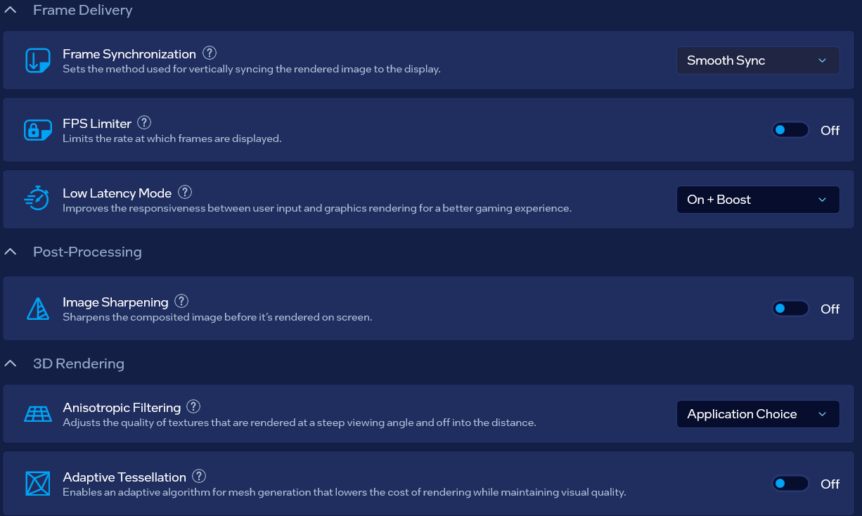

The A530M was tested with 32.0.101.6874 Drivers with Intel Graphics Command Center >> System >> Power >> Plugged in at Maximum Performance.
For Intel Graphics Software, in Graphics settings. the Sync was used Smooth Sync. And with Low Latency at On + boost.
