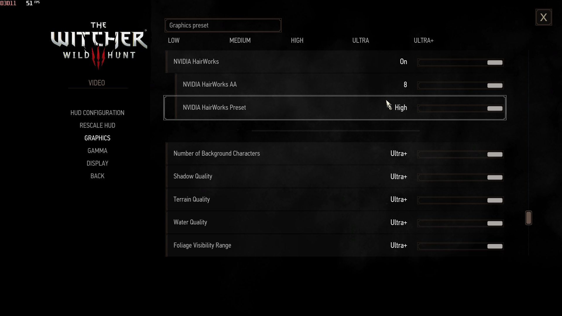

ItzAlif
15,430 Views
Thank you for reaching out!
I have actually uninstalled GTAV since I can't seem to enjoy it pretty much.
Now, I've got the witcher 3. I'm sending in some screenshots of during the gameplay. I've looked up some benchmarks of another system with almost the same specs and it was getting 65+ fps on ultra+. And here, I was getting around 55-60 while standing still and 37-50 while going to places (i.e. while riding the horse). Sorry, Couldn't check if the amount of crowd or grass affected my fps.
Also sending a couple of screenshots of an elden ring gameplay. In this case, the fps was around 35-50ish, still way below the benchmark I saw.
Thank you for your support.

ACarmona_Intel
14,777 Views
Hello ItzAlif,
Thank you so much for patiently waiting on our response.
We have noticed in one of your settings in the screenshots that you shared that you have maxed out Nvidia Hairworks, which can introduce a significant performance drop.
In regards to that, please see the article related to this, but for a different game, the effects will be the same. "Enabling TressFX* or HairWorks* Functionality Affects the Performance of Tomb Raider (2013)".
It is suggested that you turn it off and check the performance again.
By the way, we have our new released driver, which is 101.5379; please try it and check if the performance will enhance.
Furthermore, may we know what distribution platform are you using with Witcher 3? (e.g., Steam, GOG, Epic, etc.) and also what DX version are you playing Witcher 3? Have you tried both DX 11 and DX 12?
We look forward to your response!
Thank you, and have a great day ahead!
Carmona A.
ItzAlif
14,399 Views
Hello.
I've updated my driver to 101.5379. After the update, my other games (i.e. valorant, horizon zero dawn) have reduced performances. In case of valorant, it's now a bit stuttery and in case of hzd, it just crashes after i go beyond an area i guess. On the previous driver version and in this one as well, if I look at devi's grief in hzd, the fps drops to 30-40 and if i look away, it goes up to 60ish.
After you've said so, I've tried dx12 in the witcher 3 just a while ago and it was worse than dx11. It was really stuttery and also crashed after a minute or two. Also tried turning off hairworks but didn't see much difference. And I've got witcher 3 from fitgirl repacks.
Should i revert back to driver version 5333? please let me know since this version is more stuttery than the one before.
Thank you for your support. Hope to hear from you soon.
