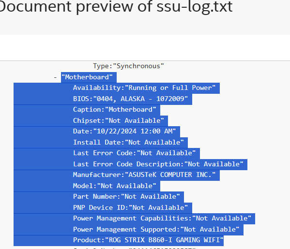

Hi @SthilAintHapnin ,
- Please provide the SSU log report and share it here so I can review your system's configuration.
Can we try this troubleshooting steps, Check if the flickering issue happens inside the BIOS configuration screen (To access the BIOS, check with the motherboard/laptop manufacturer).
If the issue happens in the BIOS configuration screen, it could be a processor issue. Try using the processor on a different known working and compatible system (applies only on Intel® boxed processors). If the issue persists, try updating the BIOS to its latest version. Currently, you have an outdated version dated 10/22/2024. The latest available release on the ASUS website is Version 1207, dated 04/15/2025.

The screen turning off does not happen in the BIOS. I have updated the BIOS and the screen turning off is still a problem. It no longer gives me a double image on screen when watching a video. I have no other way to test the CPU.
