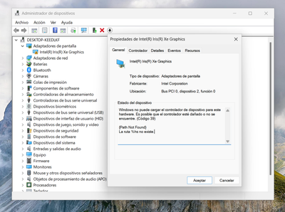

Hi, I have an Asus Vivobook X1605ZA with Intel Core I5 12500H. For a few months now, the Iris Xe graphics has stopped working. When I activate the driver in Device Manager, the laptop reboots itself and the System Recovery window appears. From there, it's a constant loop with no solution, as I uninstalled the OS and BIOS from scratch many times, of course also the latest and newest drivers, and I could never solve it. Finally, I gave up. From Safe Mode, I open Device Manager to permanently switch or disable the Iris graphics adapter for the generic display adapter so that the computer would work. I think it's a hardware problem, perhaps a power failure on some circuit... I don't know. I found the possibility of reballing the processor, but it is a slow and risky job. I am attaching some images of what happened for a better appreciation of the problem. I greatly appreciate your comments and help because it is frustrating not being able to use the integrated graphics, which had been working very well. Recently update: I try to installed the last driver that lauched in May 2th, the laptop still reboots and again it not recognize the graphics, but already not shows the windows Recovery system that is a very good sign at least for me.

Hi @VonM_Intel
1: I try installing Asus drivers from his website but same trouble. Are you reffering to those drivers?
2. The Device Manager shows this error:
3.In the Power settings I select Advance Settings and I put in Balanced because High Performance not appears.
Hello, ANDIAZ.
I noticed that the screenshot you shared appears to be in a different language. To better assist you, could you kindly provide a translated version of the error message in English? This will help us accurately identify the issue and provide a more targeted resolution. Additionally, to clarify your first point, when you mentioned installing the ASUS drivers, yes, I was referring to the OEM-provided drivers.
