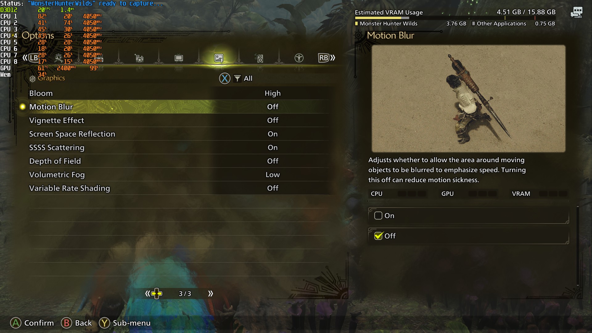

Hi everyone,
I've been experiencing some serious performance issues while playing Monster Hunter Wilds on my ARC GPU, and I wanted to share my findings and see if others are encountering similar problems.
The Issue:
The last two driver versions, 6266 and 6647, have caused significant drops in performance. Here's a breakdown of my experience:
  • Driver 6626: With Frame Generation ON, FSR 3, and graphics set to high/medium, I was getting around 35 FPS.
  • Driver 6647: Performance dropped to around 20 FPS or less, with more stuttering than before. Even after a clean DDU install, it performed worse than 6626.
  • Older Drivers (6045/6048): Rolling back to these versions drastically improved performance, with stable 50-60 FPS. Gameplay feels much smoother and more consistent.

Attached are my graphics settings. Note: changing them does little to nothing to impact performance
I have captured 180 seconds of gameplay on the 6044 driver (decent performance) as well as the latest 6651 driver (horrible performance)
I have also captured my system specs with SSU and will share them all once you provide an email.
CapX never made a configuration folder, however, I did make the rest of the requested changes to the application.

Herumacil
3,632 Views
Hey everyone,
I've just installed the latest driver 32.0.101.6732 (2nd of April i think).
The patch notes for this driver do not mention MHW at all... HOWEVER, When i launched monster hunter back up there has been a considerable improvement in FPS... now its maybe not quite where it should be... but it is a night and day difference. im now hitting anywhere between 45 - 60 FPS in places where before i was mid to high 20's.
This driver appears to make the game playable. Can anyone else confirm?
ARC A770.
MHW now happy running at:
High preset @ 1440p
FSR + FG On
