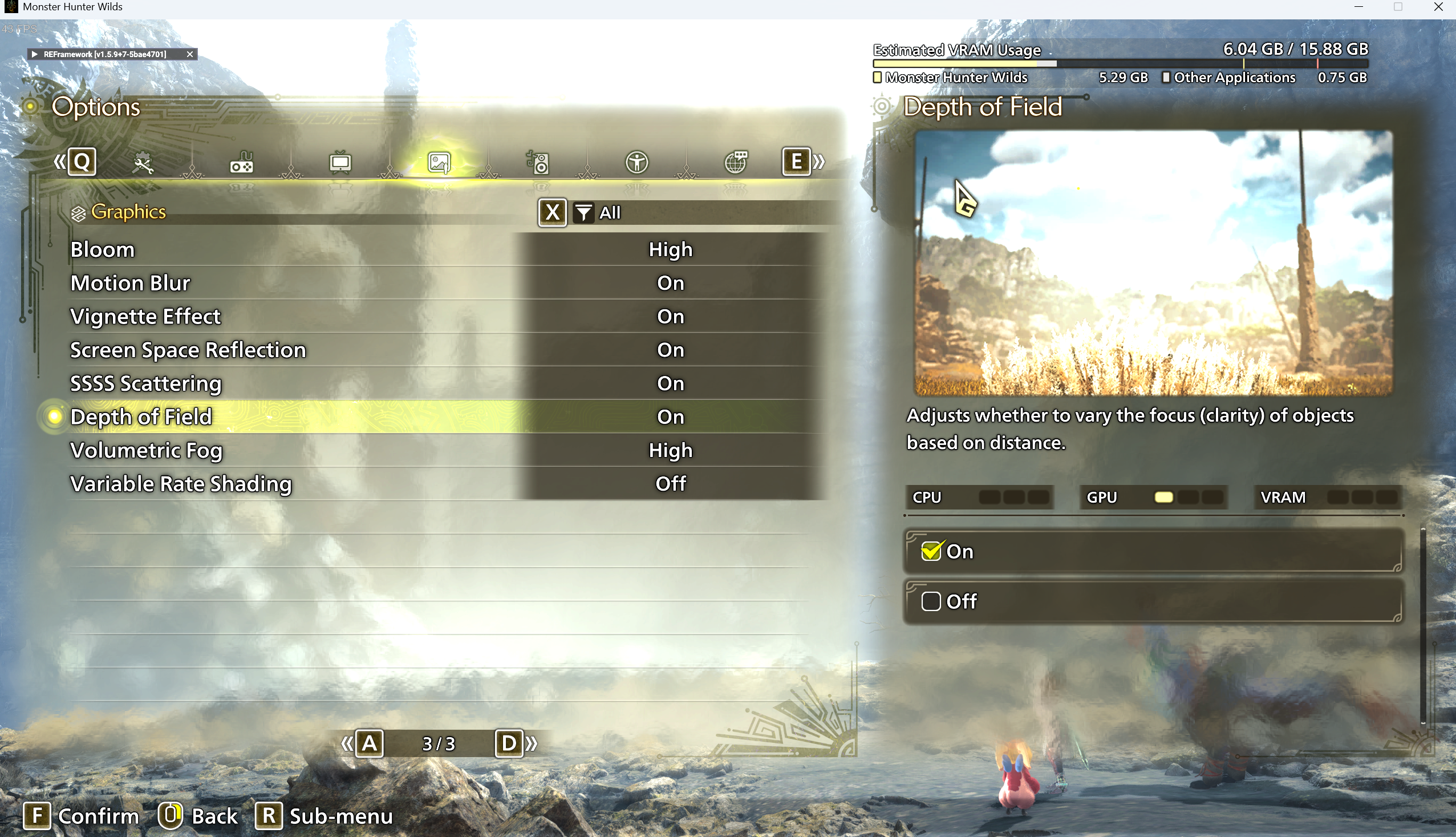

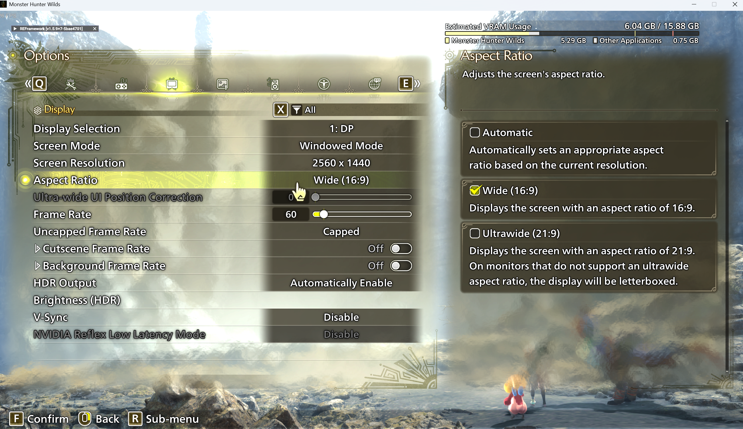

My Arc GPU perform badly while playing Monster Hunter Wilds on the latest driver.
System Specs:
  • CPU: 13th Gen Intel(R) Core(TM) i5-13600KF
  • RAM: 32GB DDR4 @ 3200 MHz
  • Storage: 2TB M.2 SSD
  • GPU: Acer Predator ARC A770 16GB
  • System: Windows 11 Pro 24H2

Thank you for sharing this information with me. I have a few clarifications and questions I'd like to ask. In your response on the other thread, you mentioned that you are experiencing the same problem. Therefore, please answer the following questions:
  1. Have you tried rolling back the driver version for testing purposes?
  2. Could you share a screenshot of your in-game graphics and display settings?
  3. Where did you download the game from (e.g., Steam, Epic Games, etc.)?

To answer your questions:
1. Yes, I have try the driver which version is 6078. You can check the CapFrameX report from CapFrameX-MonsterHunterWilds.exe-2025-03-18T213756.json. It performs better than the lateset driver. But it also has some problem like can't open the frame generation(it perform better than the latest driver even when it doesn't open the frame generation) and it performs worse when loading to a new map.
2. Pls check the pngs in the zip.

Hello GFeonix,
Thanks for sharing me the setting, it appears that the settings is set to Chinese. Could I request for you to switch the setting to English to help me better set the correct settings when further investigating it. Then please send another screenshots of your settings.
