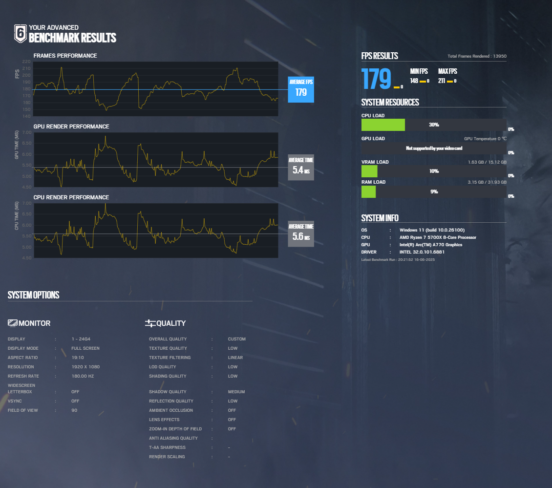

DestroyChu
2,071 Views
Using the same driver "32.0.101.6881" I am also encountering a mass decrease in performance. I have the A770 16GB Graphics card.
My main example is "Tom Clancy's: Rainbow six siege X"
The results in the images show before and after hitting record, using the in-game benchmark feature. I should note, The GPU's were fully utilized during these benchmarks and temps were around 60-65C for the GPU. I am stating this as you will see in the images, the rainbow six siege benchmarks always show "Not supported by your video card" for GPU usage and GPU temps.
I am used to dropping 10-15 fps when recording using obs. I even will provide my OBS settings in the screenshots. But I resulted in a 50+ fps drop from recording in AV1 codec at 1080p30fps. In some in-game scenarios depending on the map (Coastline is the best example) I can even go from smooth 235 fps and the second I record I'm straight down to 90-120fps with the frame-timing making it seem even lower and more delayed.
During these tests I should note that my "Video Decode" in task manager show around a 5-8% usage when recording at any moment.
Felipe_Intel
497 Views
Hello @Ptage and all. More work has been done in our drivers and the most recent 32.0.101.7026 include some improvements that should address this issue (or at least most of it).
I'd appreciate if you can test on your side and see how it performs for your use case and configuration. Looking forward for your comments
