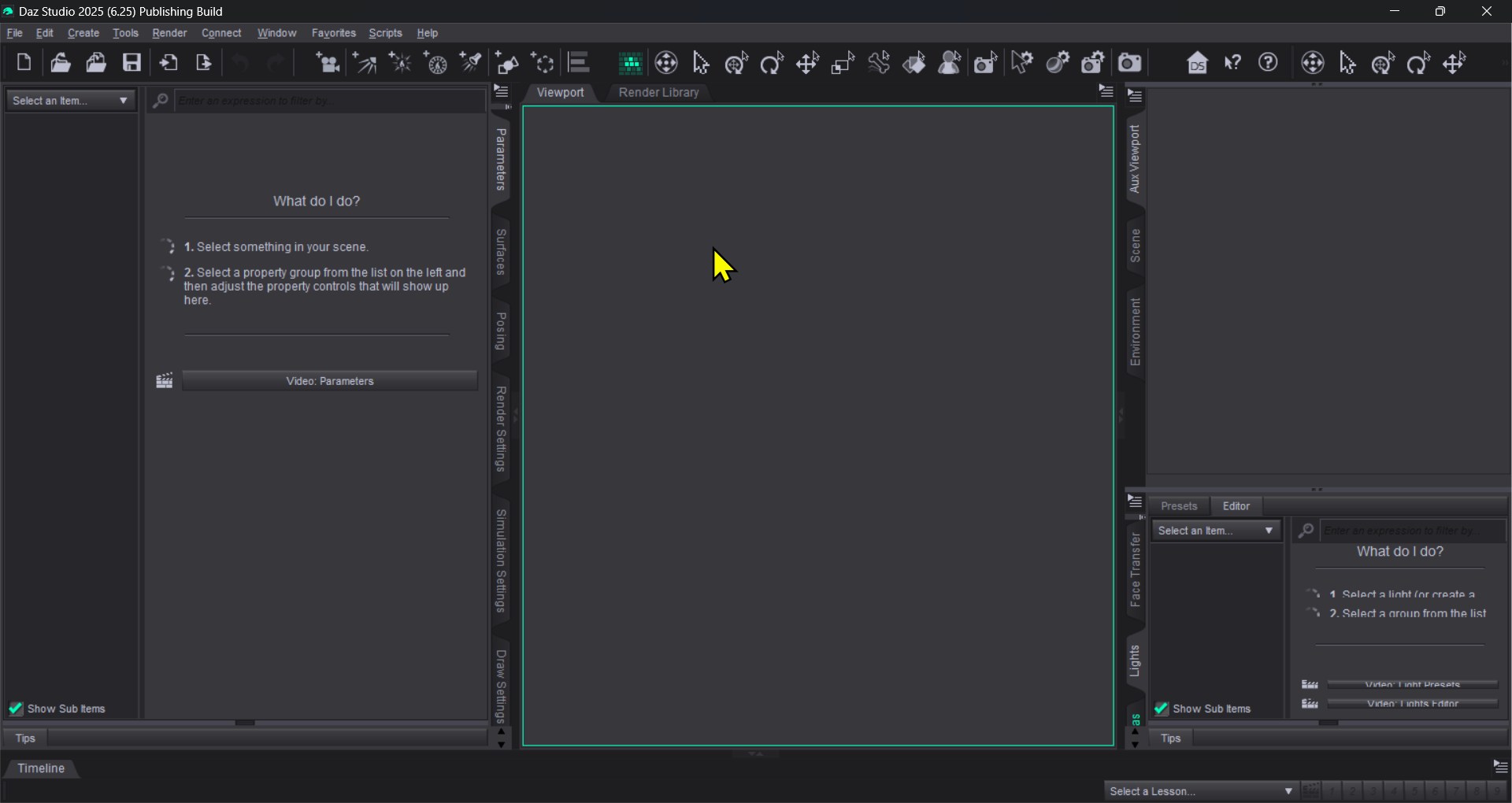

I have latest version of Intel Iris Xe Graphics driver installed on my HP laptop. OpenGL shading language (GLSL) is not supported. In order to  use my DAZ3D Studio 2025 ALPHA version I need that OpenGL shading language. Is this supported by Intel drivers and/or how can I install it?
Thank you in advance for your help

thank you very much  for your reply. Yes,  that is the newly released version of DAZ3D Studio. As published artist I have the Publishing Build version of DAZ3D ALPHA.
I also have the Publishing Build 4.24 Beta version. Unlike ALPHA this version supports the OpenGL Shading Language and other features (see attachment).
DAZ3D Developer told me that I need the OpenGL shading language supported in order to have the viewport activated.  Right now it  is just a gray window and I cannot see anything that  is loaded in the scene (see attachment). I will also need Multitexturing, Shadow Map to be supported in order to render properly.

Thank you for providing more details about the software issues you're experiencing. When an application's features or settings aren't displaying correctly, updating the drivers can often resolve the problem. However, in this case, it appears to be a hardware compatibility issue, as the software requires NVIDIA graphics cards. I strongly suggest contacting the software developer's support team to verify this requirement. They might be able to advise whether the application can run smoothly without NVIDIA graphics. Additionally, consider reaching out to your system manufacturer's support team to explore the possibility of upgrading your hardware, specifically the graphics card. While GPUs in mobile devices are typically soldered to the motherboard, some manufacturers offer solutions for using external graphics cards.

thank  you for your reply. my beta version of DAZ3D studio works well without NVIDIA card. DAZ studio requires NVIDIA
but it works also with other GCs (like Intel) and on MAC computer. In one of the forum threads in DAZ community some artists
have also reported their issues with Intel and other GCs. I'll have to contact DAZ tech support to clarify this matter and to follow up the
mentioned thread.
