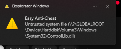

I tried to change the rendering mode from DirectX12 to DirectX11 and caused the game to start crashing with this error when joining a game

I have ran DDU again, yet the stuttering on DirectX12 and the crash on DirectX11 both persist.
I have reviewed the article you sent on performance issues in Fortnite, however it's not relevant to this case as my issue occurs on DirectX12

To ensure I address each issue effectively, please create a separate thread for the "Crashing" issue. This will allow us to focus on specific troubleshooting steps and suggestions without confusion. For the crashing issue, could you please confirm if the error message you shared is the one you receive when the game crashes? Additionally, let me know if there are any other error messages associated with the crashes. It would also be helpful to know whether the crashing occurs in both DX11 and DX12 modes.
