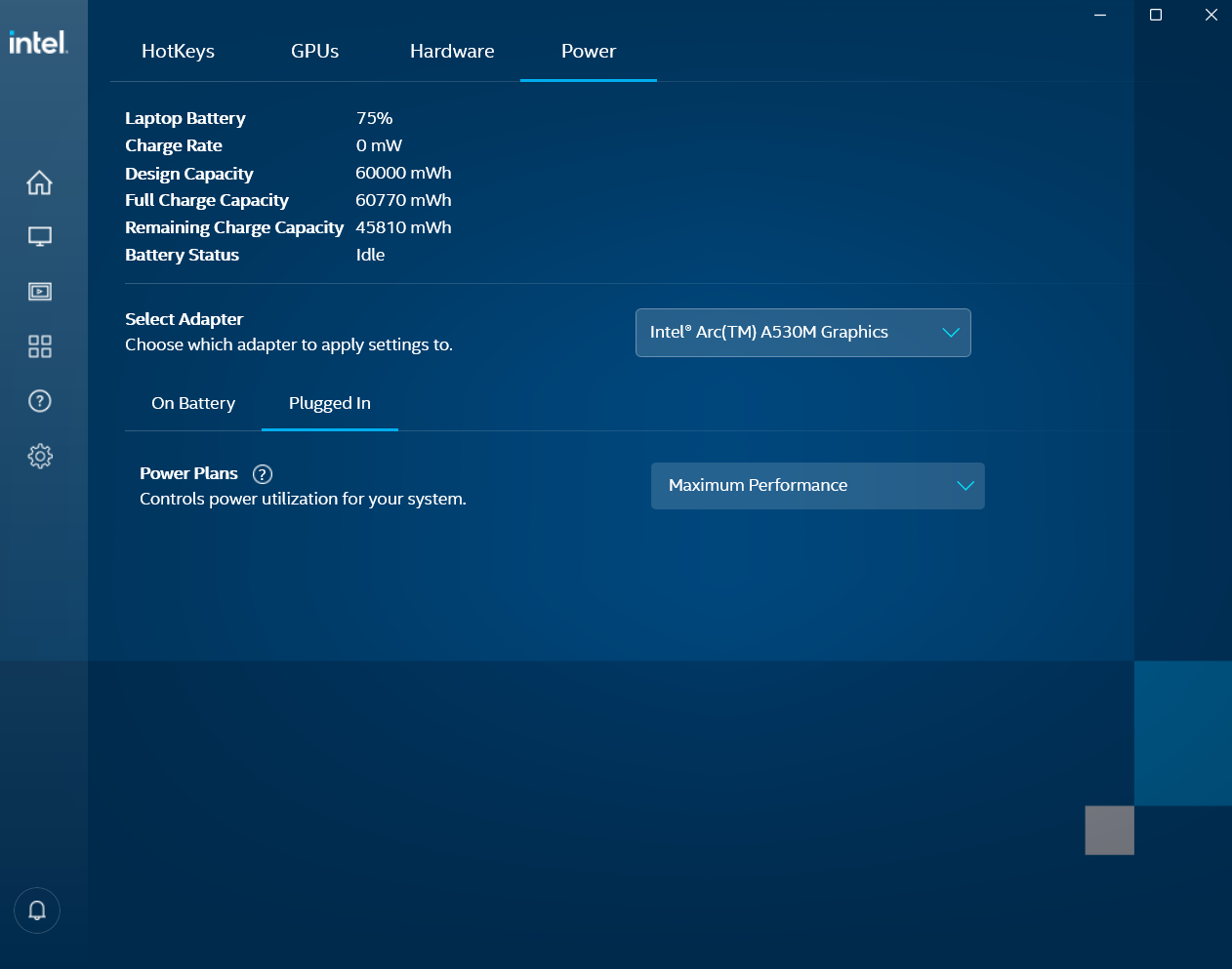

The Testing was confirm to be using Performance Mode in Lenovo Vantage, and Plugged in at Maximum Performance in Intel Graphics Software.

- Are there any specific settings in Lenovo Vantage or Intel Graphics Software that might be limiting the power usage of the A530M? (You may share screenshots or recordings)

3. No, I don't think so. Everything was on their Maximum Performance Mode.
4. As always, I tested the A530M in these games because, I don't tend to buy too much. Though these games were released before Intel Arc Graphics and when I check other GPUs like the RTX 3050 6GB it's full powered to 90W.
5. I did, however, Performance mode in Lenovo Vantage is the only one is the most optimal for Playing but, it can't reach near to its Full TGP (95W) and land somewhere near to 65W which is the Lower TGP but the HWINFO 64 confirm that the A530M has a 95W Power Cap.

For now, focus on the very right of the Monitor, that's the Power usage, as you can see, it's mostly closer to the 60W-65W. And the test was using Performance mode in Lenovo Vantage & dGPU mode and for Intel Graphics Command Center it's Maximum Performance Mode. The iGPU is disabled for accurate testing.
