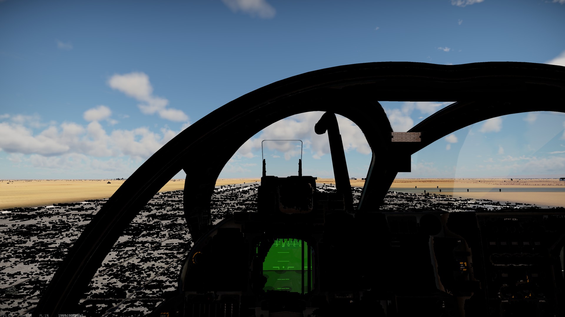

Well, I got the same Error but when it recovers there are also graphic errors (black spots).
Running a A770 in full HD and tested new cables, HDMI and DP on different monitors. It ran fine with my old Graphics card (RTX 2060). Resizeable bar is active.
-A770
-Rizen 3700x
-32gb ram
-current bios on MB
-Resizeable Bar enabled
what I did and tried:
-lower settings (less errors)
-replaced Ram and PSU (850W thermaltake) and display cables
-2nd monitor
-diferent resolutions ad fixed refreshrates as well variable rate
-Tested on 31.0.101.46XX (diferent versions) and the ...4826 version.
It seems to appear lees frequent when you lower the settings and switch to the old graphic card setting (ingame Setting, for pre GTX700 series and same old AMD cards, forces DX9 and lock sertain settings to the lowest setting). the Error after the black out can sometime revertet by changing the pov/screen (like switching to gunner sight / bomb sight). It most often appears during Airbattles... and moslt effects the Cockpit, other Planes/Tanks, Trees and bushes aswell as some concrete buildings and roads (including the Runway)
the Image is from the cockpit of A-6 Tram
