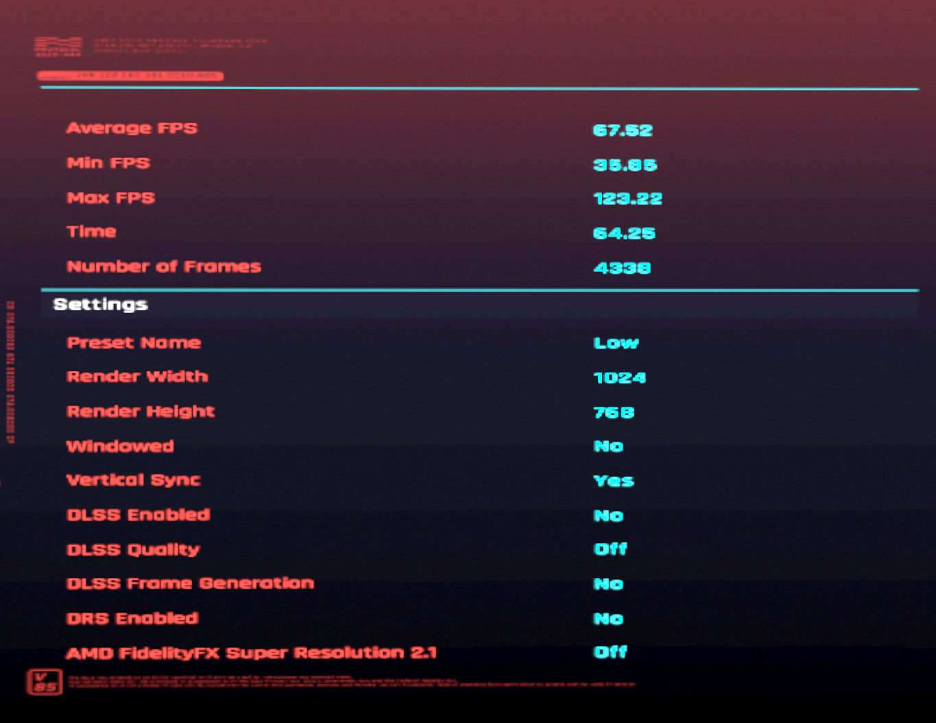

I have recently bought Acer BiFrost A770 16GB. I must say that performance in Cyberpunk is way below my expectations and looks to me like something is not right. The game performed much better on my old AMD 5600XT 6GB, which is embarrasing to be honest. Settings/resolution don't matter much, although obviously there is a difference between 3440x1440 versus 1024x768 and l;ow/ultra, but not as much as one could expect. I have also noticed that although GPU clock stays on max boost (on default/non OC 2400MHZ, which I think would indicate light workload?) and GPU Activity is 100% according to Intel Telemetry overlay, the temperature stays very low with low fan, which is very different from other games I have tested that perform as expected (Rise of the Tomb Raider). I have also noticed that GPU Core Power never reaches the limit as in other games and in general stay low (130-160W, lowering resolutions/settings can bring it to 100W, despite default limit of 210W on this card).
To sum up:
- low performance, neither settings/resolution having a big impact
- low GPU core power usage (way lower than in other games, 130-160W on 3440x1440 that would indicate GPU is not being stressed)
- low GPU temperature (way lower than in other games, indicating the GPU is not being stressed)
- high GPU activity (100% no matter the settings/resolution)
- GPU Clock max boost all the time (2400MHZ. indicating the card is having a light workload which in case of the game should not be the case, in other games on default GPU settings (no OC) the clock often is max boost, but not all the time)
I have tried all driver versions (used DDU to uninstall), different OC profiles from PredatorBiFrost app, manual OC, cleaning DirectX shader cache, reinstalling the game. None of which had any impact on the game performance. ReBAR is on according to Intel Arc Control Panel. Turning it off produces even worse performance and also noticable performance drop in other games as expected so I am sure it's working.
I have hoped that it will eventually be fixed with drivers, but it's been some time already when A770 was released and yet Cyberpunk still runs very poorly with odd GPU behaviour, not sure how Intel could claim Cyberpunk to have Tier 1 performance in this game. Although I love the idea of the card and powerfull hardware I am seriously considering returning the card, as not much improvements seem to be made. Can't believe this is target performance as on 1024x768 my mobile phone or steam deck would have better performance.

Screenshots with Low/1024x768 + Ultra/3440x1440 attached
For Ultra test I had to switch FSR to off because despite saying it's on Quality, it was swithcing itself to auto during test.

Attaching screenshots from Intel Telemetry for 3440x1440 Ultra and 1024x768 Low. GPU Activity 100% (like GPU bottleneck) even on the lowest possible settings, with other games activity drops when it's already CPU bottleneck which should be the case on the lowest possible settings/resolution in Cyberpunk as I presume. Also notice that even though the frames are low on 3440x1440 Ultra (around 30fps), the GPU Core Power is just 160W, as if the card was not utilizating it's potential. I don't expect the game to run 60fps solid on Ultra 3440, but even dropping to lowest settings does not bring much improvement (maybe 5-10 more frames) in FPS and GPU Core Power drops even more. With other games it is 190-210W on Ultra settings and 3440 resolution. I have confirmed that manually lowering the max GPU Core Power to 160W via Intel Arc Control Panel does not bring any performance degradation as well, so the GFX is trully not using more power.

Attaching another screenshot, 1024x768 native Low preset. 40fps in city centre, GPUCorePower 97W, 98% GPU activity. I have tried tinkering with all engine options, disabling different stuff but even if everything that can be disabled via engine options is disabled (cascaded shadows, global illumination, distant shadows, fog etc.) it does not bring much improvement, especially in the lows department (despite game looking like potato). On lowest resolution/settings I would expect 200FPS range, not 40.
My system is running well and I am getting the same Cyberpunk benchmark results as in various tests/reviews, so it must be some fundamental problem in the driver.
