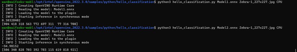

I've validated Model1 and Model2 ONNX models with Hello Classification Python Sample from OpenVINO™ toolkit 2021.4.2 and Hello Classification Python Sample from OpenVINO™ toolkit 2022.3 using Zebra-1_227x227.jpg as an input image.
Model1 ONNX model (uses QuantizeLinear and DequantizeLinear) :
Result when using OpenVINO™ toolkit 2021.4.2 : -1.9281068
Result when using OpenVINO™ toolkit 2022.3    : 0.30328402
Model2 ONNX model (does not use QuantizeLinear and DequantizeLinear):
Result when using OpenVINO™ toolkit 2021.4.2 : -54.98152
Result when using OpenVINO™ toolkit 2022.3    : -54.981552
We do notice the results are different when using the ONNX model that uses QuantizeLinear and DequantizeLinear.
On another note, could you please share your script with us so we can reproduce the same inference result from our end for further investigation? From your results, we would like to know if the results that are approximately 1.92688 is the correct or expected result.
Wan

I have one question about your answer above.
What does a number like -1.9281068 show?
The sample below appears to display the Top 10.

Hi Wan,
Thank you for your answer, I understand.
My environment is Windows 10 and C++, so I tried with the following C++ sample.
■OpenVINO 2021.4
C:\Program Files (x86)\Intel\openvino_2021.4.752\inference_engine\samples\cpp\classification_sample_async
■OpenVINO 2022.3.
C:\Program Files (x86)\Intel\openvino_2022.3.0\samples\cpp\classification_sample_async
The detailed output values are different from the first post, but the trend is the same.
(I think the difference in the output values from my first post is due to problems such as preprocessing, the order of the input images, color order, ...)
Result when using OpenVINO™ toolkit 2021.4   : -1.93943
Result when using OpenVINO™ toolkit 2021.4   : -54.9816
Result when using OpenVINO™ toolkit 2022.3   : -54.9816
A reference image is attached below.
Added display of first three output values.
■OpenVINO 2021.4 and Mode1
■OpenVINO 2022.3 and Mode1
■OpenVINO 2021.4 and Mode2
■OpenVINO 2022.3.0 and Mode2
I may not be able to meet your request, but if you have any other requests, please let me know.

Hi Northman,
Thanks for your patience.
We've received feedback from our next level.
The difference between results from OpenVINO™ Toolkit 2021.4 and OpenVINO™ Toolkit 2022.3 is that for OpenVINO™ Toolkit 2021.4, low precision transformations were not executed because the input intervals are not constant.
This was fixed some time ago in the ONNX frontend https://github.com/openvinotoolkit/openvino/blob/master/src/frontends/onnx/frontend/src/op/quantize_linear.cpp#L91-L103.
Furthermore, the results from the quantized model are so different than the results from the non-quantized model. We are still checking if it is expected behavior or not.
When low precision transformations are executed (like it's the case for OpenVINO™ Toolkit 2022.3) it can affect precision since the layers potentially can be executed with u8/i8 data types.
On another note, the probability results look suspicious. They should be within [0, 1] range but we get values like 188.1398773, etc. Is the model missing Softmax or something alike?
If you, for example, run hello_classification with alexnet from the open model zoo, the results look like follows:
