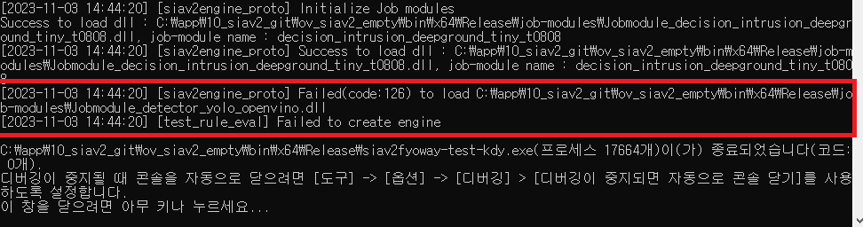

Hi Team,
When we try to build openVINO project detected error:
Failed(code:126) to load Jobmodule_detector_yalo_openvino.dll
Any suggestion?
Picture attached.

Hi WeiSeng,
Please share with us these details for further investigation:
  • Are you trying to build OpenVINO Samples and Demos or your own project?
  • Which OpenVINO version did you use?
  • Operating System

Hi Zulkifli,
Thanks for your support, please find a reply.
  • Are you trying to build OpenVINO Samples and Demos or your own project?[Reply] We're try to build demo based on OpenVINO.
  • Which OpenVINO version did you use?[Reply] The openVINO is 2023.1.0
  • Operating System[Reply] Is Windows 10 and Visual Studio env.

Zulkifli_Intel
1,717 Views
Hi WeiSeng,
Sorry for the delay.
A lot of users faced the same error with code 126. Here is one of the suggested workaround to identify the cause. Use the sysinternals utility Process Monitor https://learn.microsoft.com/en-us/sysinternals/downloads/procmon from Microsoft to trace all file access while your DLL is trying to load. With this utility, you will see everything that DLL is trying to pull in, and usually, the problem can be determined from there. You can refer to this comment. "
In StackOverflow, there is a discussion related to setting the path to the DLL file in Visual Studio. I hope this info helps.
Zulkifli
