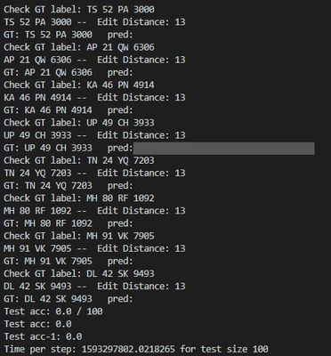

For Indian Number Plate I am getting blank space as output
tallamtharunsai
1,522 Views
I have used the plain data like black and white image for training the model.
The training loss is also very high. 15
and i have used the pattern for the eval, that is : '^[A-Z]{2} [0-9]{2} [A-Z]{2} [0-9]{4}$' for this.
I am getting the blank spaces as output
Then i have aging checked if the whole thing is working or not. So, i have tried for pretrained Chinese data and the outputs of it are like this.
All the packages are uptodate
tallamtharunsai
1,484 Views
Sorry Sir,
My bad. I have done it with different batch size but kept the learning_rate and grad_noise_scale same. So, the model is not converged. I appropriate your reply for me.
Thanks for the your time.
Tallam Tharun Sai.
