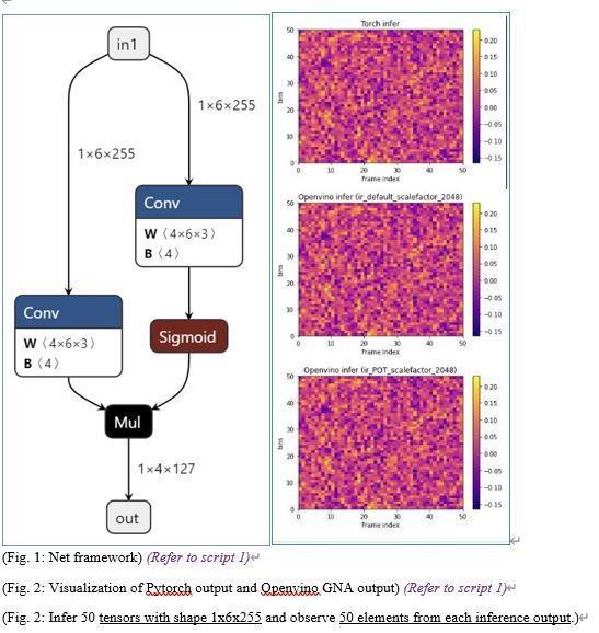

tea6329714
2,170 Views
There are 4 experiments below can help use to us clarify the causes of dropped Cosine similarity.
The aim of experiment1 & experiment2 is to observe whether the cause of issue comes from convolution’s input channel of 6.
The aim of experiment3 & experiment4 is to observe whether the cause of issue comes from quantization of precision transforming (float32 to integer16&8).

>>(Default net)In the 1st experiment, we use this two metrics to evaluate our default net’s partial operation ‘convolution’, and compare Openvinio GNA inference with Pytorch inference.
>>(POT net)In the 3rd experiment, we use this two metrics to evaluate our POT net’s partial operation ‘convolution’, and compare Openvinio GNA inference with Pytorch inference.
About Cosine similarity(based onFig4.), this level may show Openvinio GNA inference is similar to Pytorch inference.
Based on this Cosine similarity result, we can observe the similarity on the Fig.2.
#{Experiment 1 &3}
<< (Default net with scale factor 1) The L1 loss level is about ten to the negative 2 power (n × ).
<< (POT net with scale factor 1) The L1 loss level is about ten to the negative 4 power (n × ).
<< (Default net with scale factor 2048) The L1 loss level is about ten to the negative 2 power (n × ).
<< (POT net with scale factor 2048) The L1 loss level is about ten to the negative 4 power (n × ).
>> About the above result, I think POT help us to set correct scale factor so that L1 performance is well.
<< (Default net with scale factor 1) The Cosine similarity level is about 0.75.
<< (POT net with scale factor 1) The Cosine similarity level is about 0.9999.
<< (Default net with scale factor 2048) The Cosine similarity level is about 0.9999.
>> About the above result, I think POT help us to set correct scale factor so that similarity performance is well.

  • Thoughts & Questions:
  • From experiment 1&3, we can find that ‘net1 with convolution of channel 6’ have good Cosine similarity.
  • From experiment 1, we can find that different scale factor (1&2048) will affect L1& Cosine similarity. (Quantization issue)
  • From experiment 3, we can find that POT can learn and set a proper scale factor for user so that the performance of net is well even through we set different scale factors.
  • From experiment 2&4, we can find that ‘net2 with concatenation & convolution’ have bad Cosine similarity.
  • From experiment 2, we can find that different scale factor (1&2048) will not affect L1& Cosine similarity. (Quantization issue)
<< It isn’t reasonable because different scaling factor may have different performance.
  • From experiment 3, we can find that POT can’t help the condition of dropped Cosine similarity.
The 1st question is that we are not sure if our POT is correct.
>>If our POT is correct, we guess that GNA inference of ‘net2’ is incorrect (there exists a bug as we do concatenation & convolution?).

Hi tea6329714,
Thanks for sharing your validation results and thoughts.
We will check on this and get back to you at the earliest.
Sincerely,
Peh
KFPW_Intel
1,935 Views
Hi tea6329714,
Thank you for your patience.
As Peh mentioned, GNA supports a limited set of operations, kinds and combination. Accuracy issues in GNA has several intrinsic sources of inaccuracy such as PWL approximation for activation functions and integer-only math.
This case is considered as new models enabling and we have submitted this feature request to engineering for further assessment. Refer release notes on future implementation.
