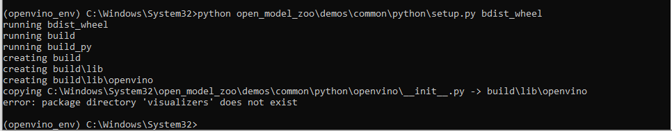

 But Step 3.2, failed as follows:
>python open_model_zoo/demos/common/python/setup.py bdist_wheel
running bdist_wheel
running build
running build_py
copying C:\Users\manue\source\repos\AI-Machine-Learning\open_model_zoo\demos\common\python\openvino\__init__.py -
> build\lib\openvino
error: package directory 'visualizers' does not exist
Interesting enough, I found a folder named "visualizers" inside "open_model_zoo\demos\common\python\" . Could the setup program be looking for that folder in some other location?
Please let me know how to fix this. Thank you for your patience and will be waiting for your reply,
Zulkifli_Intel
11,503 Views
Hello RGVGreatCoder,
I encountered the same error when using this command:
python open_model_zoo\demos\common\python\setup.py bdist_wheel
To avoid this error, please run this command:
cd open_model_zoo\demos\common\python
python setup.py bdist_wheel
