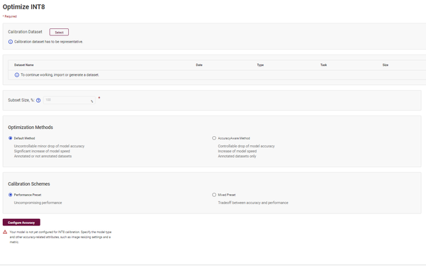

My objective is to optimize and calibrate my model for INT8 usage.
After saving the model from tensorflow2 to the saved_model format,
the input dimension is (None, 128,128,1). At the import step at the workbench,
I set the dimensions to (1,128,128,1) for batch 1 and I set the image colorspace
to grayscale. Processing with 11 files in the standard mode works fine
an gives measurement results.
My test files for "Segmantic Segmentation" are in the "Common Semantic Segmentation" format.
Can I specify for int8-Calibration that the jpg-Files are imported as grayscale?
The jpg-files in css-format are grayscale (only 1 component)
"file pic1.jpg: JPEG image data, JFIF standard 1.01, aspect ratio, density 1x1, segment length 16, baseline, precision 8, 640x480, components 1"
After that I tried to optimize with tpot (online and a local linux). There I got the following error message
The -result-archive argument is not set. The default value /home/workbench/.workbench/models/2/21/job_artifacts/artifact.tar.gz will be used.

We can optimize the model to INT8 and run the accuracy test. The current workaround is you need to change the preprocessing to bgr_to_gray, in order for it to work without error.

Thank you for sharing your steps. To run the accuracy checker and convert to INT8, please follow these steps:
Run the Accuracy Check:
-      Click on Configure Accuracy
-      Change usage to semantic segmentation
-      Run Accuracy Check
If it results in “ValueError: cannot reshape array of size 49152 into shape (1,1,128,128)”
Reconfigure the accuracy checker setting by:
-      Click on configure accuracy
-      Change from Basic to Advanced mood
-      modify the preprocessing:
  •   type: bgr_to_gray
Optimize to INT8 precision
-      Click on Perform
-      INT8
-      Optimize
-      Select the annotated dataset
-      Optimize
  •  type: bgr_to_gray
Sincerely,
Zulkifli
