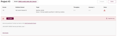

I try to convert my VGG16 ONNX model for the 11th Gen Intel(R) Core(TM) i5-1145G7E @ 2.60GHz but got 'JOB SCRIPT ERROR: Remote job failed, code: 1'.
Does anyone know what is the problems?

Thanks for providing your log file and model. Looks like the issue is with the configuration parameters during model optimization on DL Workbench.
Received message {'log': 'Exception: Image shape (224, 224, 3) is not compatible with input shape [1, 3, 224, 224]! Make sure -i parameter is valid.\n', 'error': None}
I wasn't able to access your dataset, however, I was able to obtain results using your model with the configuration below and a generated dataset. Could you please give that a try and let me know if you have any issues? If you run into any issues, please share access to your dataset for further debugging.

Hi AFuTing,
Would it be possible to share your model and dataset to reproduce the issue? I tested with a generated dataset and the VGG16 model from Open Model Zoo and didn't run into this issue. Can you also share the log file from DL Workbench?

Thank you for the reply. Attached is the log file. The below link is my model and I provide 6 images to reproduce the issue.
