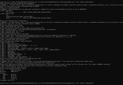

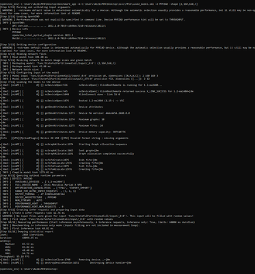

I checked your model and here are my findings:
FP32
FP16 CPU
FP16 MYRIAD

FP32
Count: 2644 iterations
Duration: 60118.04 ms
Latency:
Median: 89.33 ms
AVG: 90.83 ms
MIN: 63.78 ms
MAX: 125.76 ms
Throughput: 87.96 FPS
FP16 CPU
Count: 2668 iterations
Duration: 60081.86 ms
Latency:
Median: 88.86 ms
AVG: 89.96 ms
MIN: 69.63 ms
MAX: 126.55 ms
Throughput: 88.81 FPS
FP16 MYRIAD
Count: 2860 iterations
Duration: 60099.45 ms
Latency:
Median: 83.52 ms
AVG: 83.82 ms
MIN: 48.40 ms
MAX: 94.76 ms
Throughput: 95.18 FPS
Based on the results, the FP32 and FP16 precision that runs on CPU seems to be having quite similar performance with FPS that differ by 0.85. Meanwhile, the FP16 precision runs on MYRIAD have the best FPS among those three results which is expected.
However, bear in mind that compressing a model from its original format or full precision FP32 into smaller in size precision (FP16/INT8) has its trade-off which is accuracy. If your use case requires to be accurate, such as clinical-related results, it is not recommended to shrink the model as you need to bear with a less accurate prediction. Meanwhile, if your use case requires fast results without the need for prediction to be really accurate, then it is suitable to use a smaller size format.
