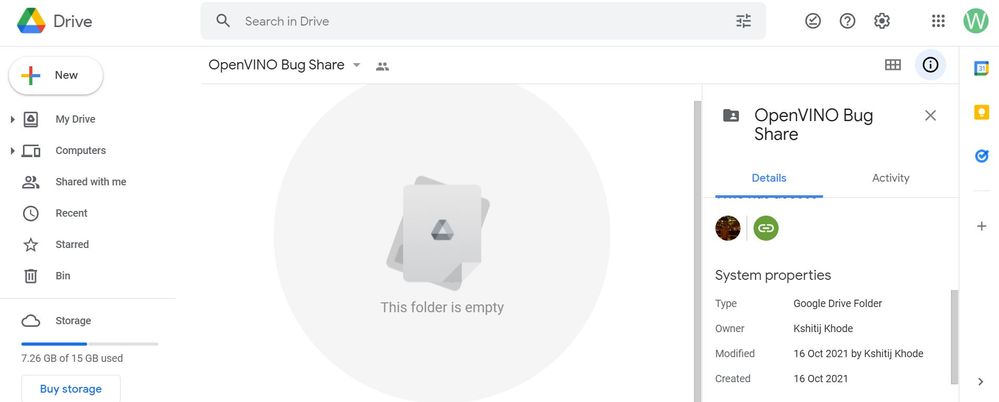

I have clicked on the link you provided. It is an empty folder and I could not find any dataset or model.
Could you please re-attach your dataset and model for us to replicate your issue from our side?
