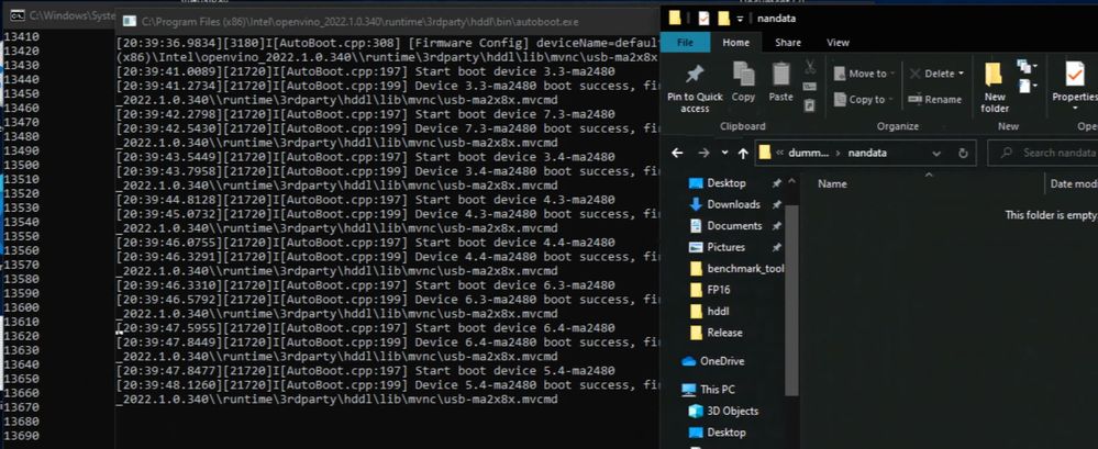

I’ve validated that running the test script with HDDL plugin (8 MYRIAD), the output results are smooth.
By the way, I also try few ways to run the test script with Intel® Neural Compute Stick 2 to get rid of the NaN output values. Surprisingly, when enlarging the model input shape, the output results are also smooth. However, changing the model input shape may significantly affect its accuracy. This proposed workaround has to clarify further from your side.
