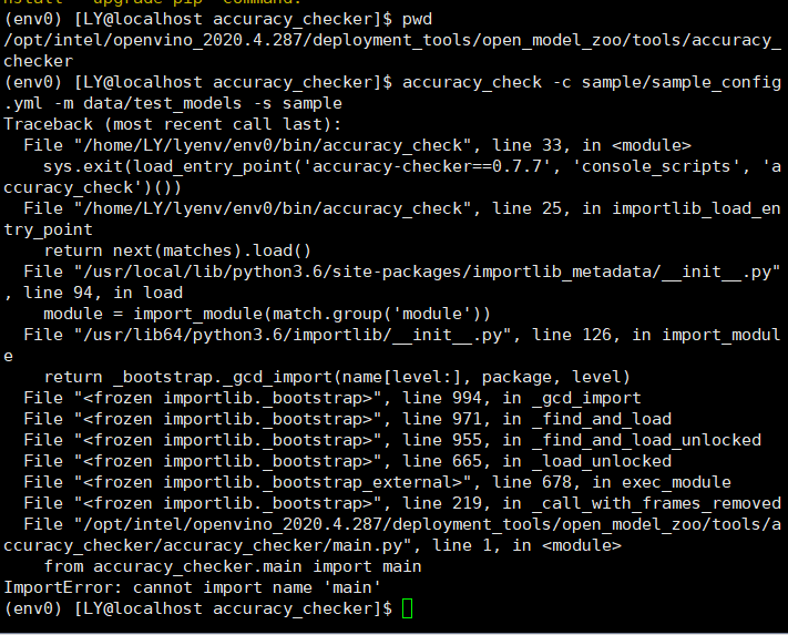

according to the official documentationDeep Learning accuracy validation framework ,I install the tool accuracy checker and prepare to run the sample to test my installation. There is an ERROR about the main.py file and I dont know WHY. If anyone can help me and thanks.

Hi Ming,
Did you try to run using this sample instruction?
I managed to validate using Windows 10 and Python 3.7.
Would you mind sharing which OS and Python version are you using?
Rizal
