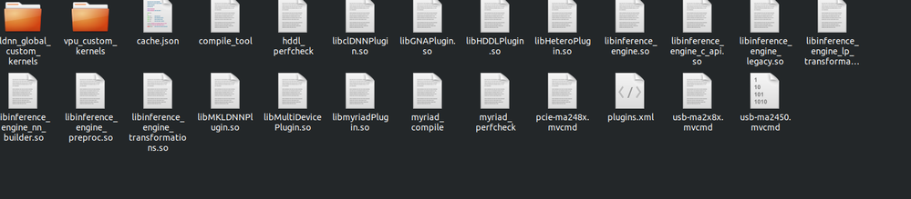

as per new release the support of libcpu extension is deprecated
but as you can see the samples are still dependent on cpu_extensionScreenshot from 2020-05-09 17-45-09.png
even these are the only shared_objects i can find in my inference engine folder, and none of them is for CPU
Screenshot from 2020-05-09 17-48-59.pngis there a way using which I can still build the samples or demoes with libcpu_extension.so can you please share whole cmake command to do that.

CPU extensions library was removed, and extensions were moved into the plugin since Intel® Distribution of OpenVINO™ Toolkit 2020.1.
Information about CPU Kernels Extensibility is available at ‘How to Implement Custom CPU Layers’ page.
Link: https://docs.openvinotoolkit.org/2020.2/_docs_IE_DG_Extensibility_DG_CPU_Kernel.html
CMake scripts to build an extension library is available at 'Build Extension Library Using CMake*' page.
Link: https://docs.openvinotoolkit.org/2020.2/extension_build.html

Hi Prateek,
Samples are not dependent on CPU extensions, as they have already been moved into CPU plugin. The CPU extensions are optional and are required for CPU custom layers only.
If you are using the object_detection_demo_ssd_async with pre-trained models from Open Model Zoo repository (as well as in the open_model_zoo folder in OpenVINO™ Toolkit), there is no need to use ‘AddExtension’, since the extensions are loaded automatically while loading the CPU plugin. This also applies to custom pre-trained models where all the primitives are supported.
For custom pre-trained models that have primitives that are not supported by CPU plugin, you can build an extension library and use the ‘AddExtension’ method of the general plugin interface to load your primitives.
