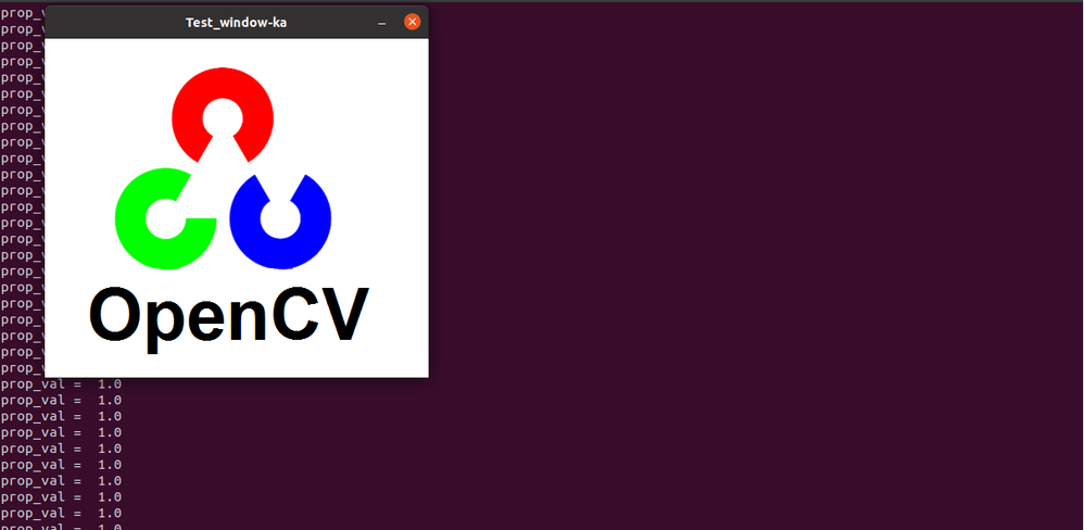

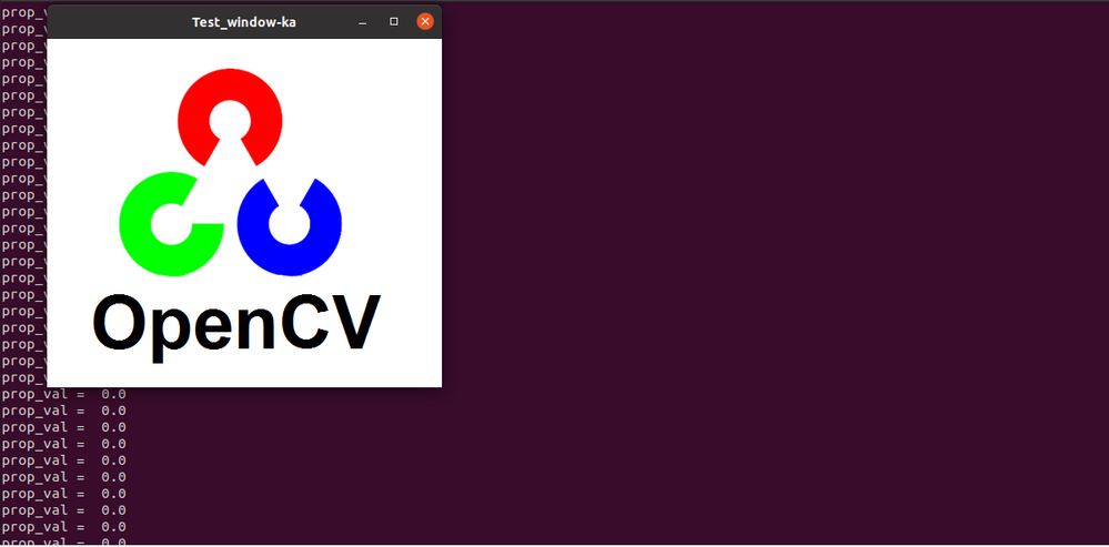

I tested your codes on Ubuntu 20.04 with OpenCV 4.5.3-openvino from OpenVINO™ 2021.4.689 and also OpenCV 4.2.0 installed from the Ubuntu Repository (sudo apt install libopencv-dev python3-opencv). Both OpenCV versions results in the same output. In addition, you can compare the changes with OpenCV 4.5.3-openvino and OpenCV 4.5.3 as documentation for OpenCV 4.5.3 is available.
Based on your codes, I get two different undesired outputs shown in the pictures below.

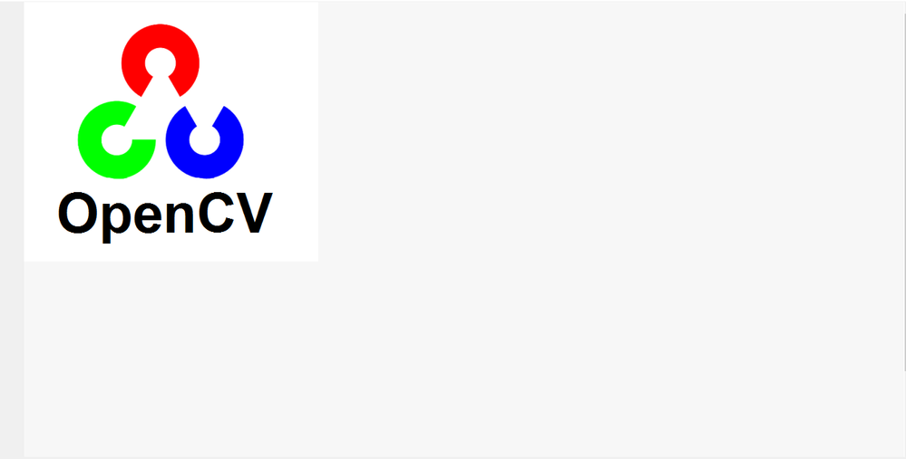

If setting “NORMAL_MODE = False”, the window outputs in full screen but not the image and the name of the window is also disappeared.
cv2.namedWindow(WINDOW_NAME, cv2.WND_PROP_FULLSCREEN)
cv2.setWindowProperty(WINDOW_NAME, cv2.WND_PROP_FULLSCREEN, cv2.WINDOW_FULLSCREEN)
If setting “NORMAL_MODE = True”, the window does not have the “Maximize” button to change the window to full screen.
cv2.namedWindow(WINDOW_NAME, cv2.WND_PROP_AUTOSIZE)
cv2.setWindowProperty(WINDOW_NAME, cv2.WND_PROP_AUTOSIZE, cv2.WINDOW_NORMAL)
Do these two outputs are the same as you mentioned as full screen issue and window name issue?

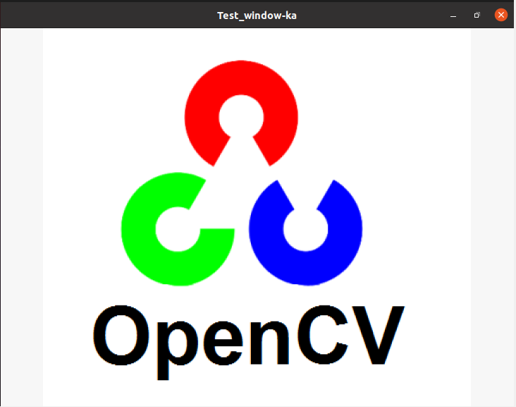

On a separate note, I only able to get the desired output in normal mode with the codes below.
cv2.namedWindow(window_name, cv2.WINDOW_NORMAL)
cv2.setWindowProperty(window_name, cv2.WND_PROP_FULLSCREEN, cv2.WINDOW_NORMAL)

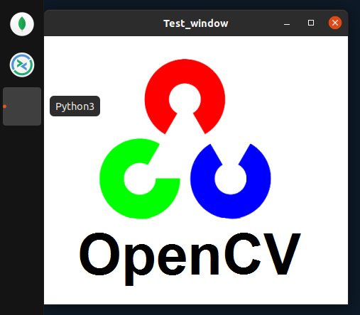

I have the similar issues on my side, i.e. application name is not being set properly (it is always being set to 'Python3', please see attached image below) and full screen mode is not scaling the image to fill the whole screen, instead it fills empty space with grey color. These issues were not reproducible in earlier builds.
Tried the following approaches to fix the issues:
  • used 'cv2.setWindowTitle' method but it does not work on my Ubuntu 20.04,
  • manipulated with window property flags, but the only change was bringing back 'maximize' button which is not required.
The example that was attached in this thread shows exactly what issues I have.
Please clarify whether the same issues are reproducible on your side.

In a meanwhile, regarding the full screen issue, I found that when adding resizeWindow function, the output is expanded and fitted to the full screen. However, there is still some empty space with grey colour. From my understanding, in full screen mode, the actual image size is expanded to the maximum by maintaining the same ratio of height and width. Hence, in this way, the image cannot perfectly fit to the full screen (rectangle shaped) and hence the rest of the space is filled with grey colour. I also need the clarification from our developers regarding this thought.
I will update you at the earliest once I get any update or feedback from them.

Based on the updates from our development team, WINDOW_NORMAL supports window to "fullscreen", but it doesn't support image resize. Hence, the image is not being scaled to full screen as the window.
A proposed workaround is to resize the image before passing it to imshow() but need to know the size of the desktop area somehow prior to image resizing.
