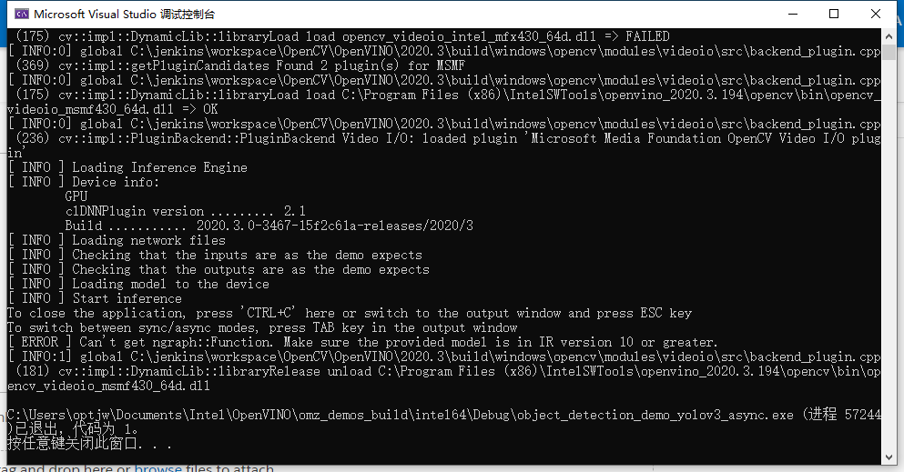

TomInChina
3,146 Views
微信截图_20200727164628.pngI recomplie the code in Windows,it also didn't work and have no error information.
