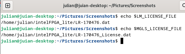

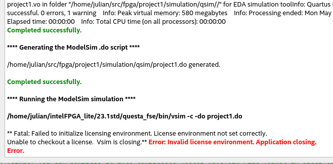

tried to run a simulation on quartus lite.  I have installed the license path, and I did so correctly.
julian@juian-desktop:~/intelFPGA_lite/23.1std/questa_fse/linux_x86_64$ ./lmutil lmdiag
lmutil - Copyright (c) 1989-2019 Flexera. All Rights Reserved.
FlexNet diagnostics on Mon 5/6/2024 15:30
License file: /home/julian/intelFPGA_lite/LR-170476_License.dat
"intelqsimstarter" v2025.05, vendor: mgcld, expiry: 03-may-2025
vendor_string: EEA0AA5A
uncounted nodelocked license, locked to ethernet address "b07b2505074e" starts: 3-may-2024, expires: 03-may-2025
This is the correct node for this node-locked license
AR_A_Intel

Welcome to the INTEL forum. Based on my understanding, Debian GNU/Linux 12 is not an officially support OS for Questa. An unsupported platform means that some things may work, but others not, and we won't put any resources into debugging or diagnosing. We recommended to use the right OS for Questa.
https://www.intel.com/content/www/us/en/support/programmable/support-resources/design-software/os-support.html
