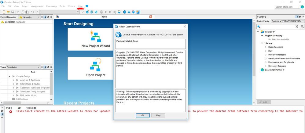

please provide the similar screenshot of your Quartus tool 'Help' menu-> 'About Quartus Prime', if possible.
