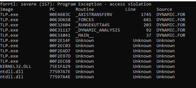

Sudhir1
2,449 Views
The programme was successfully compiled and run using Intel Fortran 11.0.72 +VS2008
when i converted it to intel OneAPI + VS2019 it doesn't give compilation error but throws below message while running
Any help on this
Thanks & Regards
Sudhir
jimdempseyatthecove
2,426 Views
>> ... OneAPI + VS2019 it doesn't give compilation error but throws below message while running
Try using the ifort classic that came with the OneAPI download. The two compilers have different code bases.
If that fails too, then this may be indicative of your Intel Fortran 11.0.72 having a bug that happened to be benign.
Was your old build 32-bit and now your new build 64-bit?
Now that you have trace back information, it is likely that AXISTRANSFERV is being passed in bad arguments. If this is not found on first call, then you may need to insert some code in AXISTRANSFERV to perform sanity checks (typically called ASSERT(...) in C++). Once you find this bug, you may find yourself having a "How did this ever run?" moment.
Jim Dempsey
mecej4
2,438 Views
There is no general solution for access violations. As you have been already advised, access violation is a symptom and the causes are many. There are several techniques that one can use and there are compiler options that can help detect bugs. If you do not already know how to do this, you will need to learn, and doing so will take time and patience.
In this case, the fact that compiling with Ifort 11.0.72 allows complete runs with apparently no errors is good news.
If you can provide the full source code + include files + data files + instructions to build and run, someone here may be willing to help. Put all  that into a zip file, upload the zip file to the cloud (such as Dropbox, GoogleDrive, OneDrive, etc.) and post a link to that here.
