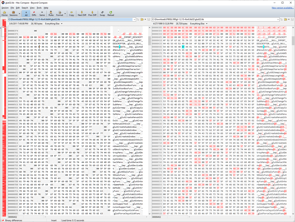

FWIW On my system (with F90GL) I link using
\F90GL\f90gl-1.2.15-ifort\lib64
in the include path
(there is also a \F90GL\f90gl-1.2.15-ifort\lib32)
In the lib64 folder, there is a glut32.lib and glut32.dll  (I am on Windows)
The binary difference between lib32\glut32.lib and lib64\glut32.lib shows they were compiled with different configurations.
The 32-bit .lib has the symbols decorated @NN suffix and _ prefix
More instructive may be the comparison of the glut32.dll's
This clearly shows they were compiled with different configurations (64-bit vs 32-bit)
