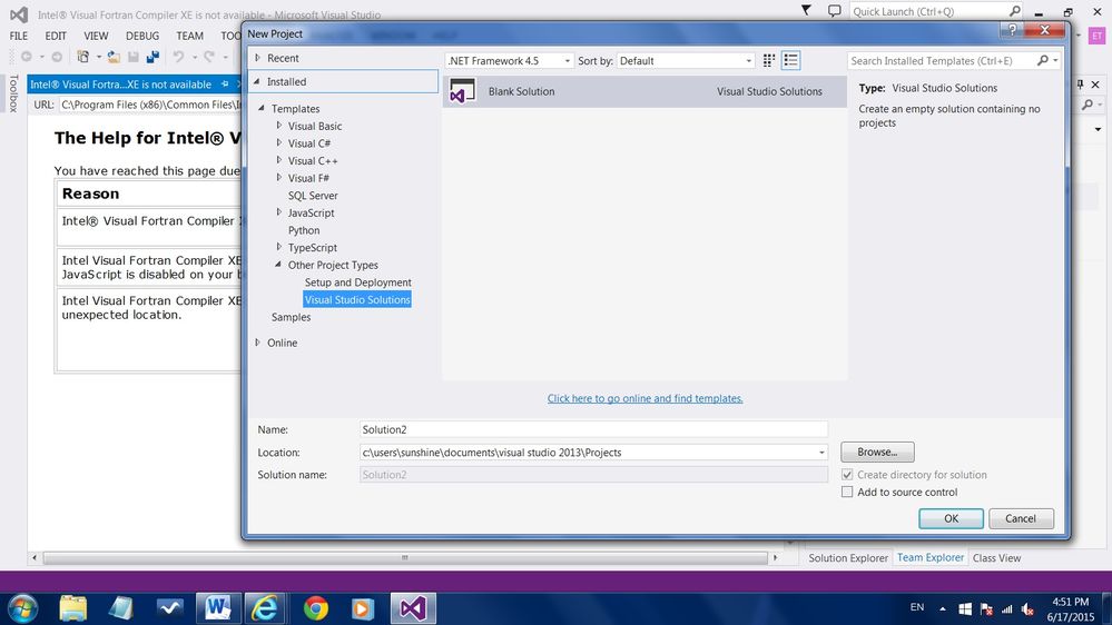

Visual Studio still does not list any of the Intel compiler tools for C++ or Fortran when I try to start a new project, but it does now list the following under the Help tab:
Intel Compilers and Libraries
Intel Software Manager…
Intel Inspector XE 2015
Intel Advisor XE 2015
Intel VTune Amplifier XE 2015
If I Click on:
Help> Intel Compilers and Libraries> Begin using Intel Parallel Studio XE for Fortan Window*
Nothing Happens.
If I Click on:
Help> Intel Compilers and Libraries> Begin using Intel Parallel Studio XE for C++ Window*
Another window with documentation about the compiler opens up but I am unable to complete the instructions for staring a new Intel C++ Project.
For both Fortran and C++ if I Click on:
File> New> Project>
None of the Intel tools are listed only the tools that came with visual studio come up.
If I use the “Getting Started with Intel® Parallel Studio XE 2015 for Windows*” welcome page within Visual Studio and then under “Design and build your application”, click on “Intel® Visual Fortran Compiler”, then an error message is displayed stating “The Help for Intel® Visual Fortran Compiler XE is not available”.
Any help is greatly appreciated.
How do I get the Intel Parallel Studio tools to be properly integrated into Visual studio? Or have I made a mistake along the way?
Kind regards,
Liz
Steven_L_Intel1
2,095 Views
You installed Parallel Studio XE after installing VS2013? Try the repair instructions in https://software.intel.com/en-us/articles/troubleshooting-fortran-integration-issues-with-visual-studio/ and see where that gets you.
