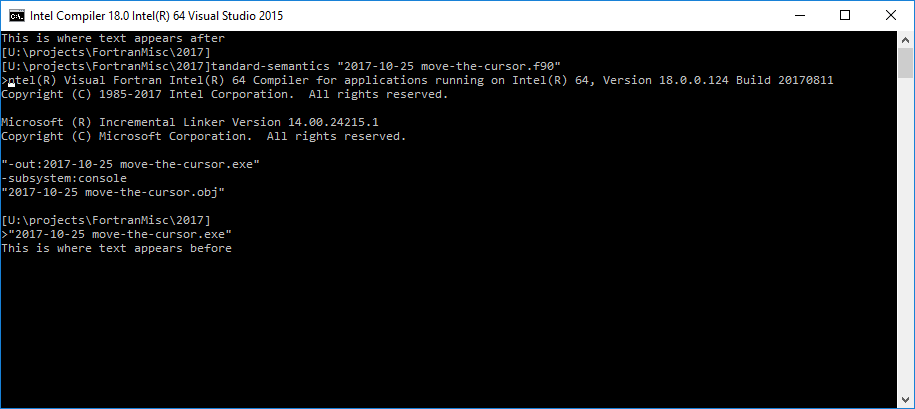

A trivial variiation of Jim's code works for me.
PROGRAM MoveTheCursor
  USE KERNEL32
  IMPLICIT NONE
  TYPE(T_COORD) :: coord
  INTEGER(HANDLE) :: hConsole
  PRINT "('This is where text appears before')"
  hConsole = GetStdHandle(STD_OUTPUT_HANDLE)
  coord = T_COORD(0, 0)
  IF (SetConsoleCursorPosition(hConsole, coord) == 0_BOOL) STOP "error"
  PRINT "('This is where text appears after')"
END PROGRAM MoveTheCursor

Eugene_E_Intel
2,090 Views
Note that the MSDN link provided by Jim Dempsey has C calls.  You don't need to know, how to call C++ code, in order to use that MSDN example.
Doesn't the sample code provided by IanH do what you need?
