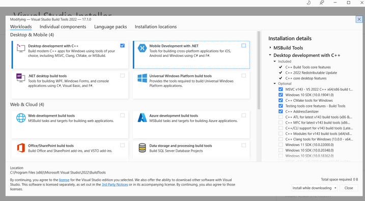

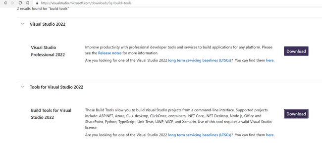

- Download and install Visual Studio Build tools 2022 with default options checked. (DO NOT UNCHECK OR CHECK ANY OTHER OPTIONS.)
https://visualstudio.microsoft.com/downloads/?q=build+tools

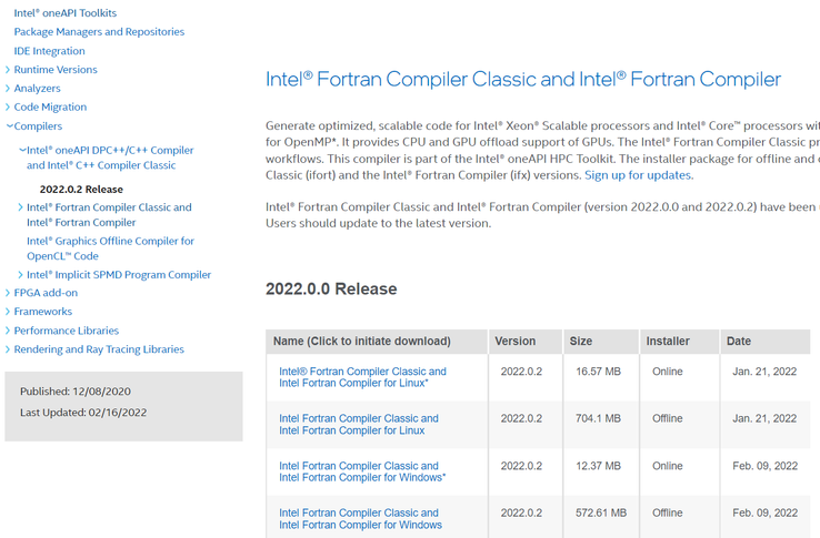

- Install Fortran compiler from this website
https://www.intel.com/content/www/us/en/developer/articles/tool/oneapi-standalone-components.html
- Install Math kernel Library also from above website

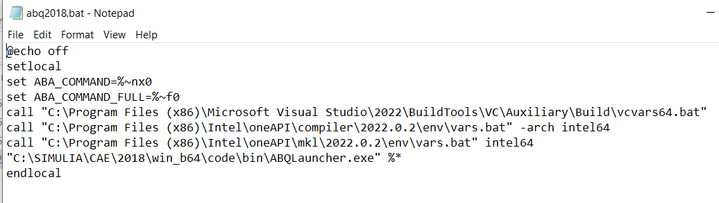

- Add following lines in abaqus.bat file
call "C:\Program Files (x86)\Microsoft Visual Studio\2022\BuildTools\VC\Auxiliary\Build\vcvars64.bat"
call "C:\Program Files (x86)\Intel\oneAPI\compiler\2022.0.2\env\vars.bat" -arch intel64
call "C:\Program Files (x86)\Intel\oneAPI\mkl\2022.0.2\env\vars.bat" intel64

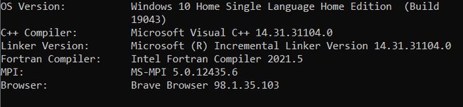

- To check if linking is done, run:
First open Abaqus Command prompt and then enter following:
abaqus info=system
Output should be like shown below:

hi,
I am following the same steps on Abaqus 2022, VS:2022. but facing problem of linking Fortran compiler after typing "Abaqus info=system" in cmd window.it shows
this is for the path.
please help me in resolving the issue
I am able to resolve this issue by adding the "vs 2022" after intel64 in abaqus bat file, but currently iam facing problem with verification. after typing "Abaqus verify -user_std"in cmd window.
The ABAQUS comment is not quite correct anymore. in the command window run C:\Program Files (x86)\Intel\oneAPI\setvars
and see if that helps.
i have to add this in "C:\Program Files (x86)\Intel\oneAPI\setvars" in Abaqus bat file
