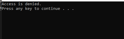

Please asses following code. My PC fails to produce any output whenever dimension exceeds 4x10^8.

On Windows, even 64-bit, you are limited to 2GB total size of code and static data. Windows will do strange things if you try to run an EXE that comes close to that limit. The linker may or may not complain, depending on just how the program is structured.
Linux allows larger static data if you use -mcmodel medium. If you make the array ALLOCATABLE, you can use more than 2GB on 64-bit Windows.

I have used ALLOCATABLE. Now, I get the insufficient virtual memory, and last accurate output is 2x10^9 (On a computer having 16GB RAM, core I7). My personal (Intel Core M3) computer went hang which has a RAM of 8GB when I set maximum array size of 2x10^9.
I have tested code by having virtual memory increased to 10GB. Still, same result.
I have attached two images. Those images show the result of code without the use of ALLOCATABLE. [PC CAN`T RUN, Access denied]
Check the following image and attached FORTRAN code:With  ALLOCATABLEWith ALLOCATABLE
