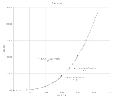

The program runs on a single processor in cubic n, so by the time you get to 2600 it takes 38 minutes to run.
I enclose a graph, I ran it three times, first as your program and then twice as the modified.
Anyway, it was fun.

I tried your suggestion, the program ran consistently slower.
Here is the amended timing figure
The blue line is the lost time for your suggestion in centi-seconds, so I can plot it.  Interestingly n = 100 does not really fit the other data and I ran it a few times to check.  No idea why it is so much slower at 100.
Even if I manage to OMP the program, 2600 n in a 10 core is still going to take 2 to 3 minutes.
John

First graph adds the data to my earlier graph, with an R squared of 1 it is close to exact cubic
This next graph shows the relationship -- dead linear
first set is slow and second set is faster at 60% of the run time
Which is half expected as I placed the CPU_TIME's in the wrong place, as well as the JIT (if any) and/or code injection overhead should have occurred once on pass 1 of array size=4x4.
The pass loop should have been replicated to encapsulate each matmul method. In an actual application, it is likely that the matmul method would be called more than once, as well as many times on the same allocated memory. It is important to know the
Do once time
vs
Do many times
Jim Dempsey
