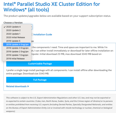

To whom it may concern,
I have successfully installed the Fortran Compiler and have run problems creating Abaqus Subroutines.
Now - after some debugging efforts - it turns out that what I am wanting to do indeed runs with
Version 19.0.5.281 Build 20190815.
I have version Version 2021.6.0 Build 20220226_000000 - there seems to be some bug for this particular version with Abaqus.
How do I get the earlier version?
Many thanks.

you can download that from your Intel Registration Center account if you have purchased a support entitlement.  It is not available without a license.  More information is HERE
WIth your entitled account, you use the PSXE downloads on Intel Registration center:

May I suggest that first you do some analysis to see if it isn't a compiler bug but rather an error in your code?

Steve,
I've checked this - the User Subroutine compiles and runs in both cases but delivers different (correct) results with the Version 19.0.5.281 Build 20190815 of the Compiler.

1,415 Views
Now find out why. Which calculation gets a different result when compiled with the two versions. How different is the answer?
