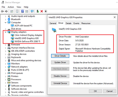

What Intel processor are you running on? OpenMP TARGET is supported on processors with Gen9 instructions or greater.
Which device driver did you install?
There may be some confusion since you also have NVIDIA installed.
Noemig4
4,644 Views
Hi Barbara,
I have an Intel® Core™ i9-9900K Processor (Coffee-Lake generation) with and  integrated video card Intel UHD Graphics 630 (GEN 9)  and an NVIDIA GeForce RTX 2080 Ti. I have been thinking that maybe I need to completely disable the NVIDIA card and just keep the UHD 630 card on. Do you think this will help? Both of the video cards are ON (see image attached).
I have the driver version 27.20.100.8681 that seems to be the latest one available for the  Intel UHD Graphics 630.
Thanks for your input.
Noemi

Steve,
I disabled the NVIDIA card in two of my computers  and I got two different issues. Please see my reply to Barbara above.

I am not sure on Windows, but Intel GPUs can co-exist with NVIDIA.
A lot of the issues we see with odd behavior like this are due to incorrect or missing driver.
On Windows, Intel has a tool to look at ALL the device drivers on your system and update them if needed with the most recent driver(s).  Go HERE for this "Intel Driver & Support Assistant" application.  Download, open your downloads folder and run it.  I had to reboot after installation to run it.
On linux I have a set of tests to try.  I stood up a PC laptop for testing.  Let me try a few things and I'll get back on here with more suggestions.  I just have to see if Windows works the same or close to my Linux environment.

4,573 Views
Ron,
Thank you for the feedback and suggestions.
I updated the drivers for the UHD 630 card. See my image below:
Steve_Lionel
4,584 Views
Windows has no problem with a dedicated NVidia GPU alongside Intel integrated graphics - I ran this configuration for many years.
I am skeptical that this is a device driver issue, and instead think it is something that the Intel OpenMP support is doing.

Open a x64 Command Window and run the sycl-ls.exe command as shown below.  This should detect your drivers and report out
Noemig4
4,543 Views
Ron,
I think my drivers are ok, see images below with the output on my two computers:
Computer 1:
Computer 2:
N

Noemig4
4,519 Views
Ron,
I compiled and execute the Matmul -offload matrix program that you sent me.
I am getting the following error in my computer 2:
My computer 1 is still giving me the same error with OMPTarget.dll, see below:
Thanks!
N

Computer 2 - what version of oneAPI and IFX do you have?
ifx -what matmul-offload.f90
It looks like there is another version of OpenCL on Computer 1.  Notice the complaint about OpenCL versions.
Computer 1 - Can you try this from the command line, doing the compilation like I show along with the run?
Also, for Computer 1, before you run try this
set LIBOMPTARGET_DEBUG=1
then run matmul-offload.exe
