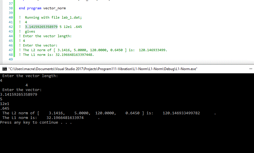

From me.rice.edu  Professor Akin --
program  vector_norm

JohnNichols
Honored Contributor I
5,141 Views
Akin's program give the same results in the latest Fortran classic compiler:  which is nice to know.
